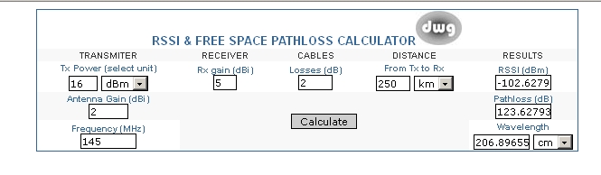

I received a 145MHz 40mw beacon from a high-altitude balloon more than 250km distant. I'm using a 5/8λ omni-directional antenna, and an NBFM receiver with a sensistivity of ~0.25uV (-120dbm), much better than a broadcast FM receiver.
The theoritical distance one could detect such a signal is shown here:
This shows I had a fade margin of 16db, which means that the power of the transmitter could be reduced 16db (from 40mw to 1mw), and I should still be able to detect it...
