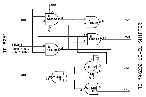

You can multiplex serial port to get any number of ports. See schematic below for a 2-Port multiplexer/demultiplexer. 74LS02 is actually 74HC02.
