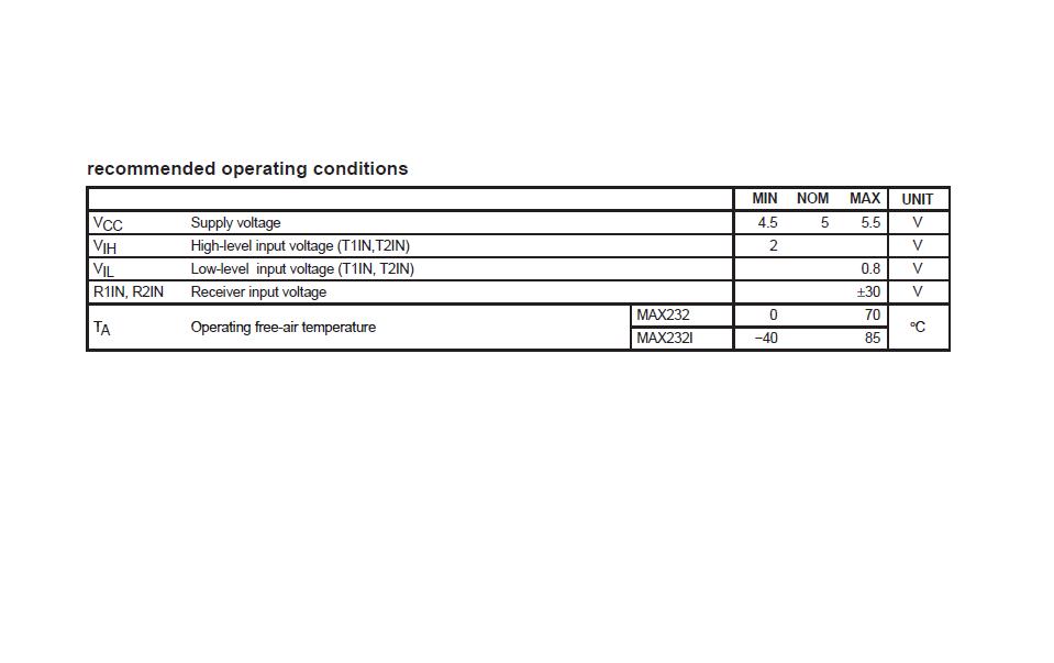

I think so it can but just wanted to confirm.Also can we take the output of the TX pin from the 18LF4620 and connect it directly to a MAX 232(5V) will it work fine with the 18LF4620 operating at 3.3 volts? Will the bit voltages be causing a problem.

Yeah i saw it, i wanted to know that could we program it directly since it has a supply voltage of 2.5 to 5.5 volts.So i think we can program it with out the mods.The PIC24FJ16GA002 has supply voltage range of 2.6 to 3.3V.

check whether MAX3232 would suite your needs
MAX3232 would definitely do the job but it isnt available in the market.Here is a part of max 232 datasheet from which i think the max 232 will work.
