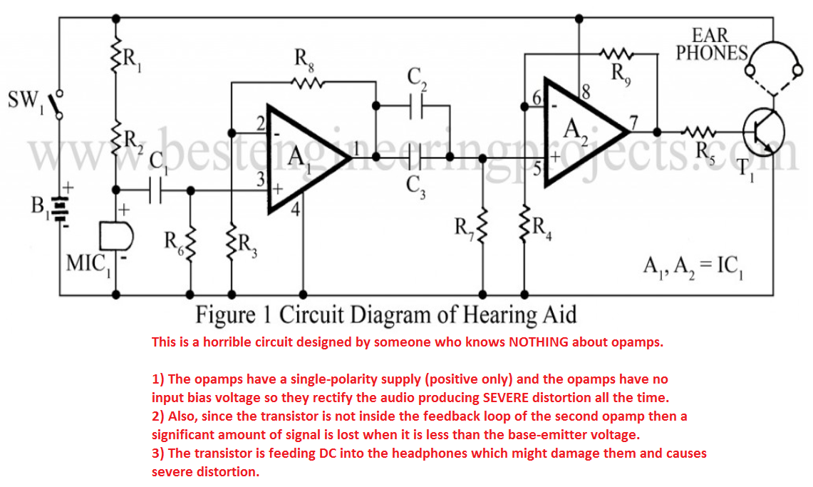

There is a hearing aid thread here that linked to a horrible circuit that would produce extremely high distortion.
Without building it I would like to hear it and demonstrate how bad it is. I would like to feed the SIM program a WAV file of music and speech and have it play the output. Can LTspiceIV do it?

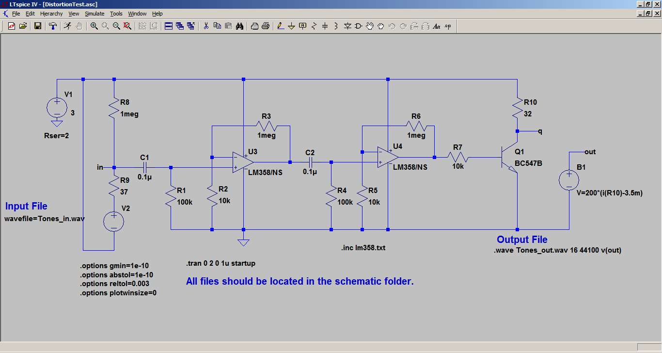

Here's the circuit AG is referring to.
Attached are .wav files of a 20 microV RMS 1kHz sine-wave tone used as input to the circuit, and the resulting distorted output from the circuit. Just delete the .txt extension to use them. Also attached is the .asc file, showing the syntax for .wav input and .wav output.

The LM358 components are missing...:(
eT
I also cannot simulate an LM358 dual opamp.

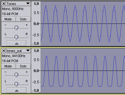

Your "Tones Out" file sounds exactly the same as your "Tones (input)" file. But the output is supposed to be half-wave rectified by the opamps.
I want to hear the mess the circuit makes with speech and music that have continuously variable levels that will play nothing when the level is below the base-emitter voltage of the transistor.
EDIT: I think your circuit should use a 32 ohms resistor as its load instead of the low value extremely low resistance inductor.
I think your SIM program needs a hearing aid and some opamp theory.
Both non-inverting opamps have no input bias voltage so they rectify any input signal. Rectified audio is obvious on a 'scope and sounds awful.
The output of each opamp is the positive-going parts of the AC input signal. The transistor does nothing until its input voltage reaches about +0.65V.
Sorry about that. See attached.
Shouldn't do (if you've got your hearing aid switched on, AG :)). Here's a shot of an extract of the two waveforms, the latter showing rectification as expected.

I've added bias.
Here's a zip file with Alex_T schematic and the distorted wave file.
You'll have to manually run the wave file in Media player when the sim completes. (if you are using windows). Sim take a while...about 167 seconds on my fast computer.

You added some DC bias to the signal generator (why?) but not to the opamps.
In the original unbiased circuit I cannot see how the signal anywhere can swing negative as you show it at an output from something (from what and from where, what is B1?) when nothing has a negative supply voltage.
I think the output of each opamp normally swings positive up to about +1.8V but is close to 0V when the input swings negative.
Since the transistor also is not biased then its collector output will be just a narrow slice of the output of the second opamp when it swings from about +65V to about +75V.
In the sim I posted, B1 is a 'behavioral voltage source'. I used it simply to scale and DC-offset the output voltage (across the 32Ω inductor modelling an earphone) to make it suitable for recording as a wav file.
I misunderstood...I thought at the mic input because dc is present there on the original crappy circuit. Aren't you wanting to duplicate the crappy circuit so it will reproduce a horrible sound?:confused:
The mic signal is AC coupled to the amp via a capacitor, so for small AC signals any DC bias at the mic does not contribute to the amp's distortion.
The original circuit used an electret mic which has a Jfet impedance converter that must be powered.
The inputs of an LM358 dual opamp are PNP transistors that still work perfectly when their DC voltage is the same as the negative supply voltage which is 0V in this circuit.
The input to the opamp swings positive and negative but since the opamps have no negative supply voltage and have their inputs biased at 0V, then the opamps do nothing and keep the output slightly more positive than 0V when the input swings negative thus the opamps are rectifying the signal.
The transistor is also not biased so its base-emitter "turn on" voltage is a threshold that waits for its input signal level to reach which makes the distortion much worse.
Agreed, the opamps and transistor all have a rectifying effect. I deliberately chose a very small input signal amplitude for the sim, which results in just the onset of clipping. Any larger input results in a more or less square-wave output. Despite the awful distortion, the output is still intelligible.
