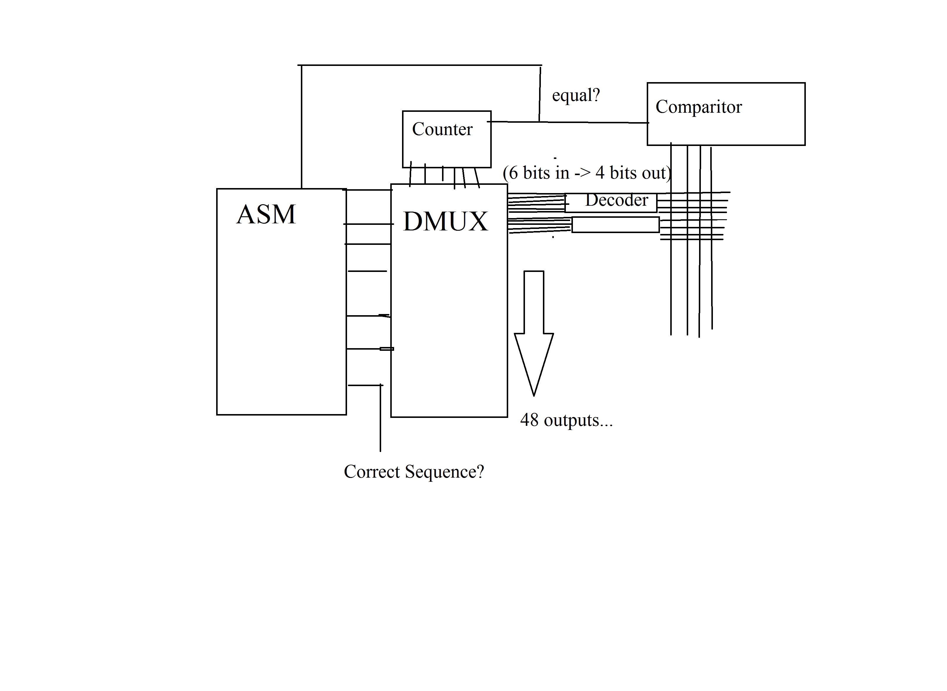

wow...this assignment is going to be looong... The problem is that my sequence is actually 48 characters long...
Okay, looking at this this way I will need something as shown in the attached picture...
The Input Signal (equal?) is there to increment the counter and the ASM to go to the next state.
I also need to decode the 6 bit input signals into a 4 bit output signal to compare it with the signal I am getting in...
It seems impractical to do this by hand..also I dont think I can use a "48 Channel DMUX" so I probably need to use 12 of 4 channel ones..

fouadalnoor,
How about submitting the 48 numbers in the sequence they are needed. Do you have to start on a particular number?
Ratch
You should have only three states, waiting for start, comparing and found. The comparing state would have a pointer to the next character to be received.
The biggest problem is getting false starts which would make you miss the data but that depends on what the data is.

Well the problem is that the data sent in will be 1 bit at a time.. So '1','0','0' etc also random data might be send before, after the actual sequence that I want..so I need to make sure I ignore everything other than the exact sequence that I want.
Oh and I do have to start on a particular number since that's how the sequence is sent in..
fouadalnoor,
It appears that I missed the fact that you needed to do the problem by ASM techniques, so ignore what I said before. Do you have a complete written statement of the problem, or was it given verbally with a long explanation? If the problem can be sent as an attachment to a post, then that would reduce some this back and forth discourse in regards to missing information.
