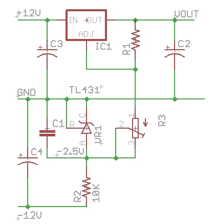

If you can make a -2.5V supply and connect the pot to -2.5V then the output can go to 0 volts.
I used a TL431 to make -2.5volts.

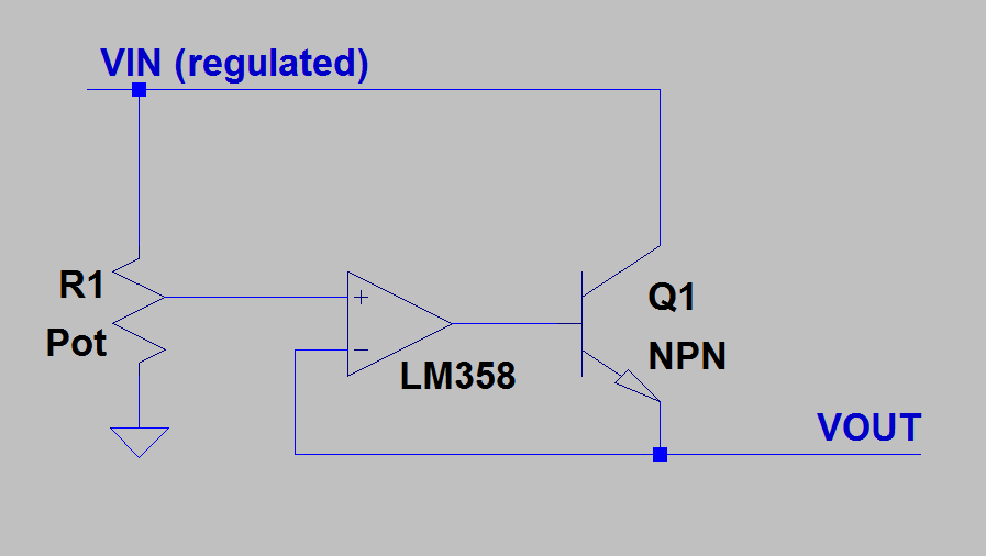

Sorry, I missed the word 'driver' in your post. You can make your own regulator circuit using an opamp (e.g. LM358) and a transistor if you can't get the LT3080. I'll attach a schematic (you'll notice it's very similar to the LT3080 block diagram). The voltage on the + input of the opamp will set the output voltage.
