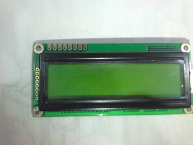

can anybody know what is type of serial LCD display?
yang_0925
if can hlp me find out data sheet .
thank you.

better You make a more clear photograph by choosing closeup shot and then while posting edit unwanted areas using 'crop' . it is very difficult to see anything on this photo.
Is there any company logo or something similar on that display?
That would it make easyer to find out.

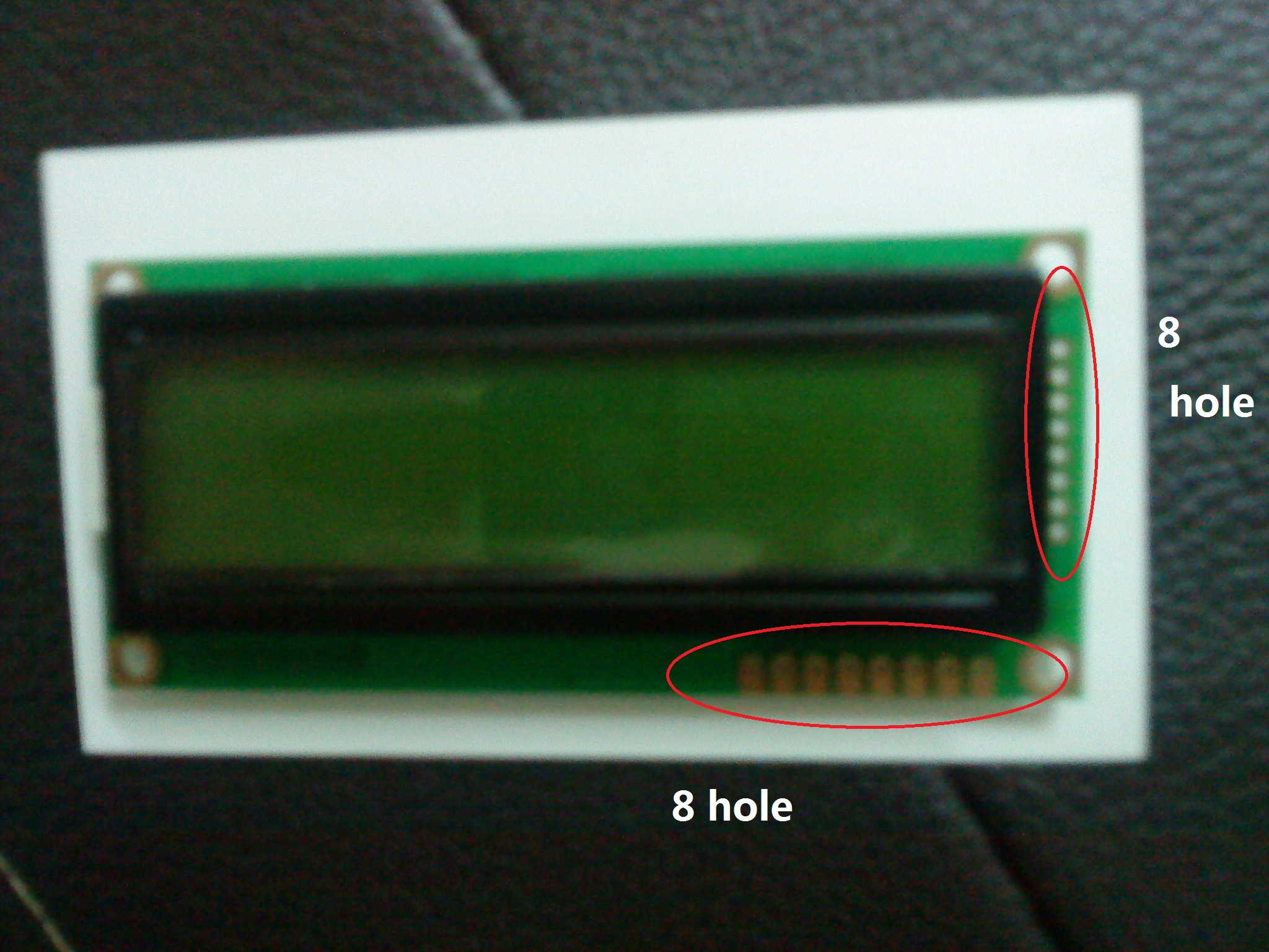

more clear pic
sorry for late reply.
hope u can hlp me

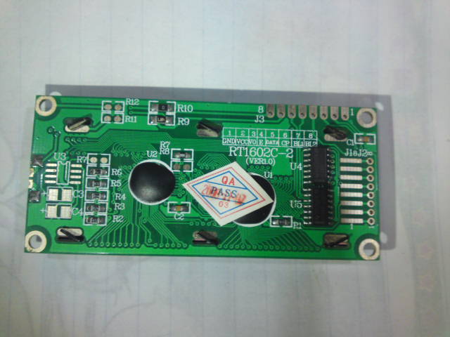

Ian, same data sheet I linked to. :)
Ron
Ian, thank you and please excuse me as I run to wash the egg off my face. Damn, I miscalled that one.
Ron
