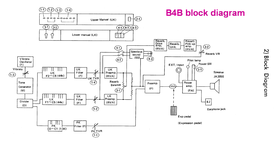

Here's the block diagram of the Yamaha Model B4B.
Is there a similar block diagram for your BK7i model?
I used to have the BK4C service manual in hardcopy, but couldn't fine it anymore. The organ from this age used many small cards connected together with bundles of wires and was very hard to trace the problem when there's a fault. I think all the boards use transistors except the main tone generator which uses ICs.

Yes the problem could be from the Main Amp board but it can be also from further up-stream.
When the expression pedal was at the minimum, is the loud tone still there?
