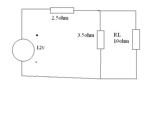

I am trying to do a text book question on networks,
the question is ,, use thevenins and nortons theorem to determine the current flowing and the voltage across RL in the network diagram,
i have attatched the diagram.
Thanks for the help

It's just a simple voltage divider. You don't need either theorem to find the answer to that one.

For the Thevenin voltage, calculate the voltage across the points where RL is connected with RL removed.
For the Thevenin resistance, remove the voltage source(s) and replace it (them) with a short circuit. Replace any current sources with an open circuit.Then calculate the resultant resistance. Imagine that you connected an Ohm meter across across the points where RL is connected with RL removed. The reading would be the Thevenin resistance.
For Norton, calculate the short circuit current. This is the Norton current. Calculate the resistance as I said above.
Once you have the equivalent circuits, it is then easy to calculate the currents & voltages.
