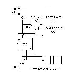

Can anyone please confirm this is valid?
bigal_scorpio
Active Member
Hi to all,
I was just hoping someone could verify this circuit.
It is designed to output PWM on pin 3, but having built it 3 times I am beginning to wonder if its OK, as I said I have made it 3 times on Veroboard all to no avail.
Thanks for looking............Al
There is a mistake in the schematic. Here is the fixed version:
Sorted!
Hi to both of you,
Thanks guys, thats got it cracked!
Now I can get on with the PWM project for She who must be obeyed! ;)
Thanks again..........Al :)
