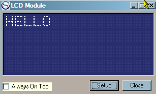

this is the code which i have used. this code is o display a character S on the lcd.
we got many black patches on lcd.

Your program runs OK in the Oshonsoft simulator, see this image, I added the 'Hello' message.
You are not initialising the LCD correctly, so when you run the program with real hardware you will see black blocks.
Look at Nigels tutorials on how to do this, use the link shown near my signature st the bottom of this post.
