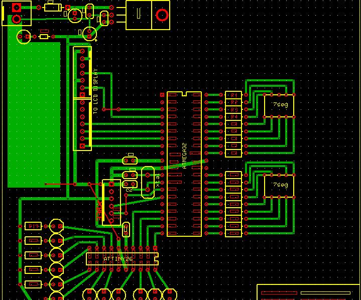

can anyone tel me is there any problem with this circiut?

can anyone tel me is there any problem with this circuit and any other comments?anything that can be improved?

I dont see a Vo pin connection for the LCD contrast control.? Pin 3
Also I would place a 100nF cap close the MCU power pins.
EDIT: whats that device connected in series with pin 10 of the MCU.?

I dont mind checking circuits, but its impossible to verify the accuracy without a schematic as a reference.:rolleyes:

Is pin 10 only connected to a cap? Where's VCC
Are the 7 segment displays CC or CA (where do they get power?)
Might need a pullup on RESET (pin9) but I'm a PIC guy so the answer may not apply to AVRs.

its just a .1uf capacitor...i have some circuits made the same way.if it is not there also not a problem.

its CA and there is no big problem if i dont put a reset button na...

If its not a problem HOW does the Atmega get its Vcc +V supply.:confused:
Pin 10 is Vcc.??

Well it's not going to work without VCC. You're supposed to put a 0.1uF across VCC & GND. Your CA displays also do not have a power source, the CA displays Anodes should be connected to VCC. Your LCD display has no contrast pot, you will need it.
Why two microcontrontollers?
Without a schematic for us to see we're working in the dark.

Im not complaining about you making a mistake, I know we all make mistakes, but you keep saying there was nothing wrong with pin10.
The atmega will not get any supply thru the 100nF from the power wire, it needs a direct connection.
The 100nF should be across the power wire and the 0V wire.!
Do you see what I am saying.?

Look at this modified image.
