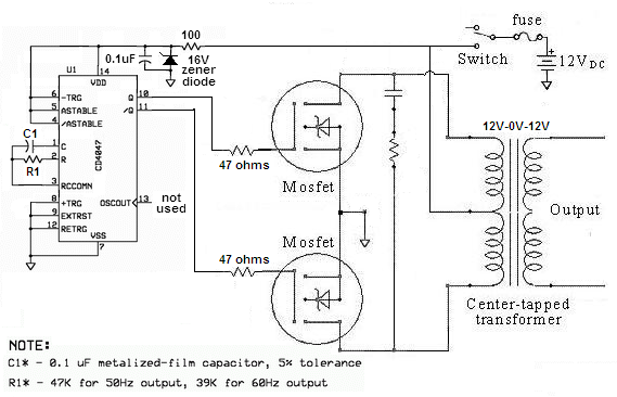

I think a simple square-wave inverter using a CD4047 driving Mosfets should be like this:

It's an amazing looking circuit Uncle scrooge. So is the nener diode present to ensure that voltage transients don't blow the CD4047.
So I am back to where I was with a previous circuit in not fully comprehending what is happening at the supply, am I correct in thinking that the battery can supply two sources with enough voltage because they are in paralell to each other i.e. the CD4047 and the two n-channel mosfets and transformer. I suspect that a much higher proportion of current will be drawn by the mosfets and the tranformer so this is the explanation for me that fits, is there another one.
I'm also guessing that the capacitor and resistor to the right hand side of the mosfets must be present to absorb transients again which would possibly come directly from the battery or be caused due to the inductive nature of the transformer.
Thanks Uncle scrooge :D I was feeling like a dog chasing his own tail.
The CD4047 operates with a very low supply current.
The Mosfets do the hard work of switching many amps from the battery into each side of the transformer winding, alternating.
This is a very simple square-wave inverter. Many electronic products don't work from a square-wave. They expect the much higher peak voltage of a sine-wave. But this square-wave has the same average voltage as a sine-wave to drive incandescent lights the same.
This simple inverter does not have voltage regulation so with a fully charged battery and with not much load, the voltage is too high. When the battery is almost dead and with a heavy load, the voltage is too low.

I recomend you use some kind of boost to drive the gates of the mosfets.Tipicaly 1A peak is used to drive them nice and fast.Thing is you need to get the mosfet in to saturation and back to fully closed in the shortest time.This is becuase the half open state creates a lot of heat.So if you drive the gate faster the mosfets will heat a lot less.That means better efficency and a smaller inverter.
Common solution is a 2 trasistor buffer.Works realy well and certanly worth the few cents for them.
As for mosfets i would recomend IRF3205. Its in a common TO-220 and has only 0,008 Ohm resistance when saturated.Should result in almost no heating.
But if the MOSFETs are only being driven at 60Hz the switching losses will be pretty low, even if the switching speed is slow so it doesn't matter.
Using a 12V transformer is also pretty pointless because the output voltage will be much less than the rated input voltage at full load. Even if you powered your 12V transformer from a 12VAC sinewave you'd only get 230V on the secondary off load, when a load is connected it could drop as low as 180V which is totally useless.
Build a modified sinewave inverter and use a 9V transformer rather than a 12V transformer as it'll give you a high enough peak voltage, even at full load.
A problem with a simple square-wave inverter circuit using good Mosfets is when both Mosfets switch at the same time and conduct a momentary high current at the same time. A modified sine-wave circuit turns on one Mosfet at a time with a pause between them.
But when switched fast enugh this time is next to nothing.There is a simple solution to it tho. A series resistor on the gate and then a parallel diode on that resistor that lets current out of it. This was it thurns off in a instant but has a tiny delay for a thurn on.
