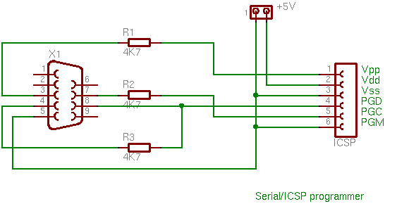

Transistorman Member Jul 8, 2010 #1 my pic not want to connect again to my computer again , what should i do ? or it just only for one time programming ?
3v0 Coop Build Coordinator Forum Supporter Jul 8, 2010 #2 The F in 12F629 stands for flash. You should be able to reprogram it.
P Pommie Well-Known Member Most Helpful Member Jul 8, 2010 #5 If you have turned off Mclr and used the internal clock then you may have problems blanking/reprogramming it. Depending on which JDM you have there may be a way around it. Mike.
Transistorman Member Jul 8, 2010 #6 ICSP Programmer i use it because it cheap Attachments icsp_prog.png 4.6 KB · Views: 4,527 Last edited: Jul 8, 2010
