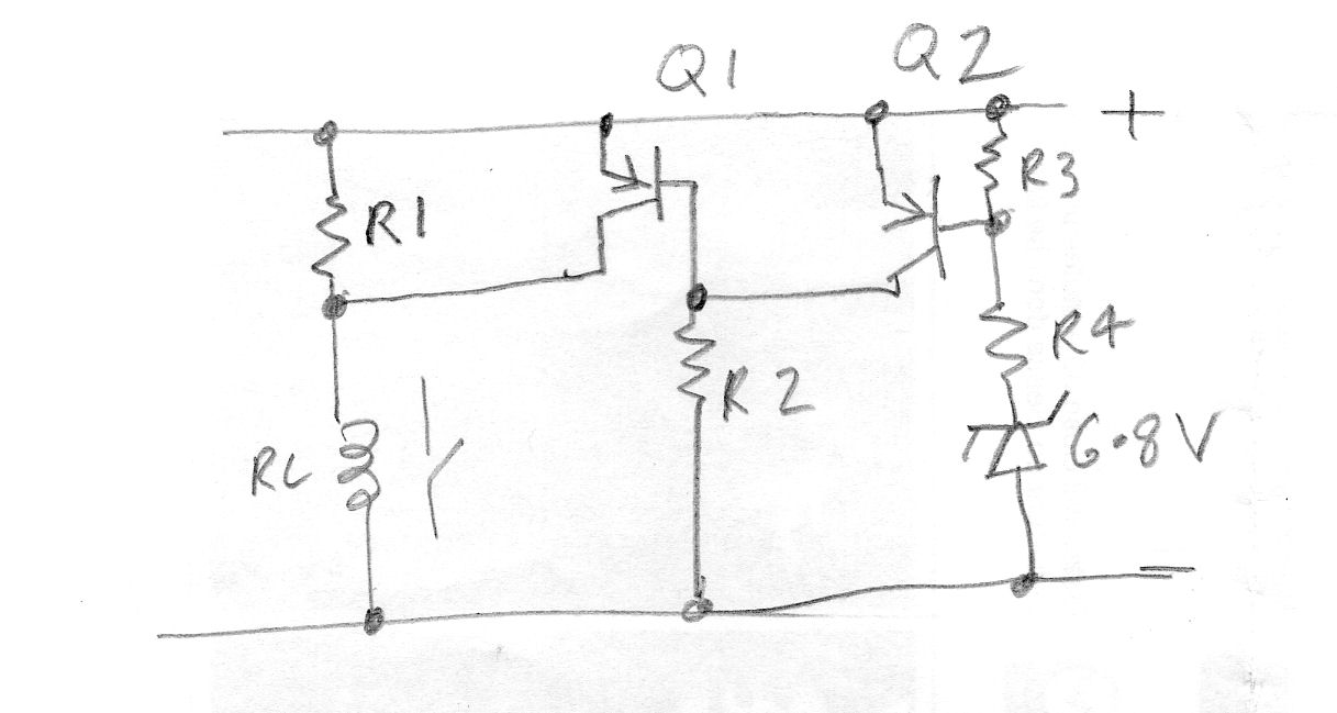

If I understand your problem correctly you want the relay to opperate with either 5 volts or 12 volts without the relay being damaged when opperated from 12 volts. I did initialy think about suggesting an 5 volt LDO regulator but I do not know if they would have a low enough dropout voltage for the relay to work when the regulator was supplied with 5 volts. here is a suggested solution. It is just a modification of the resistor idea.
Provided the relay coil takes less than about 80 mA then a BC557 (Or similar) should be OK for Q1 and Q2. You will have to work out the value of R1 to suit the relay current. R2 would be 1K, R3 10K, R4 4.7K The zener diode could be either 5.6 or 6.8volts.
This is how the circuit works. When supplied wit 5 volts Q2 would not turn on as the zener diode would not conduct. As Q2 was not conducting Q1 would be turned on shorting out resistor R1. If the voltage was above the zener voltage plus vbe of Q2 (About 0.6V) then Q2 would turn on. This would short base to emitter of Q1 so it would not conduct and hence not short out R1. If the relay coil takes more than 80 mA then some components would need to be changed.
