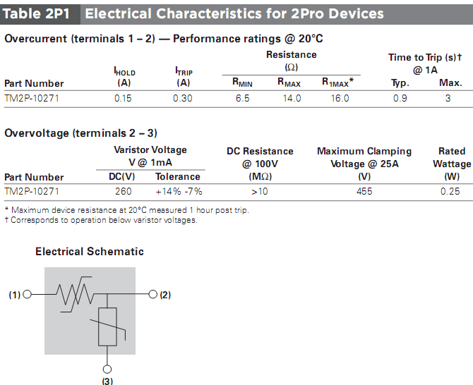

Hello,
I currently have 2 MOVs in my product, one from Live to Earth and the Other from Neutral to Earth.
The mains can be either ~250V or ~120V.
Now I want to replace each MOV with the following MOV+PTC:
untitled-png.36150
Will it be ok to use this MOV+PTC?
Thanks.
Why do you need to clamp the voltage from Neutral to Ground?
Do not put a current limiter in series with the Ground Line. I'm not sure about a current limiter in the Neutral Line?
It seems to me that only the following have any benefit: Current limit in Line. Voltage clamp Line to Neutral. Possibly, Voltage Clamp Neutral to Ground.

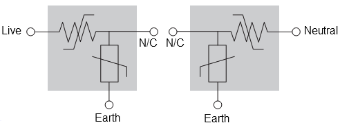

I need to clamp the voltage from Neutral to Earth since a lightning strike might also affect the Neutral wire.
Moreover, the Neutral wire's resistance might increase its voltage to high levels.
The PTC is not connected in series with Earth, but in series with the MOV, as follows:
untitled-png.36166
Is this configuration alright?
Moreover, do the electrical specifications of the MOV and the PTC allow me to connect them to the mains (~250V or ~120V) in that way?
Thanks.
Your method of connecting these is not correct. They require connections to all three terminals. The load current is supposed to flow from 1 to 2, and the clamp is supposed to happen between 2 and 3. So, for the one installed in the line side; Line to 1, Load to 2 and 3 to Neutral. You do not want to limit the current in either the Neutral or Ground wire, so if you insist on clamping Neutral to Ground, just use a two-terminal MOV or Transorb.

The thing is that i want the PTC to protect the MOV, not the load.
Moreover, the load can draw up to 16Arms, so a ~10ohm PTC is not something i can connect in series with the Load, you see?
This device is designed for circuits like phone line inputs to a modem where the 10Ω resistance is not an issue. If you put the PTC in series with the MOV, then you might as well as not bother putting in the MOV at all!
Look at Transzorbs. Read the application notes on the Vishay web site.
For a surge protector to receive UL certificate, it needs to have thermal fuse protection against protector meltdown (UL1449).
The time it takes to the PTC to start increasing its resistance is longer than the time it takes to the MOV to become a shortage.
Therefore, when a lightning strikes, the MOV shorts the beginning of it to Earth, but if the voltage is still high, then the PTC will protect the MOV and only the Load will get damaged (instead of both Load and MOV getting damaged).
