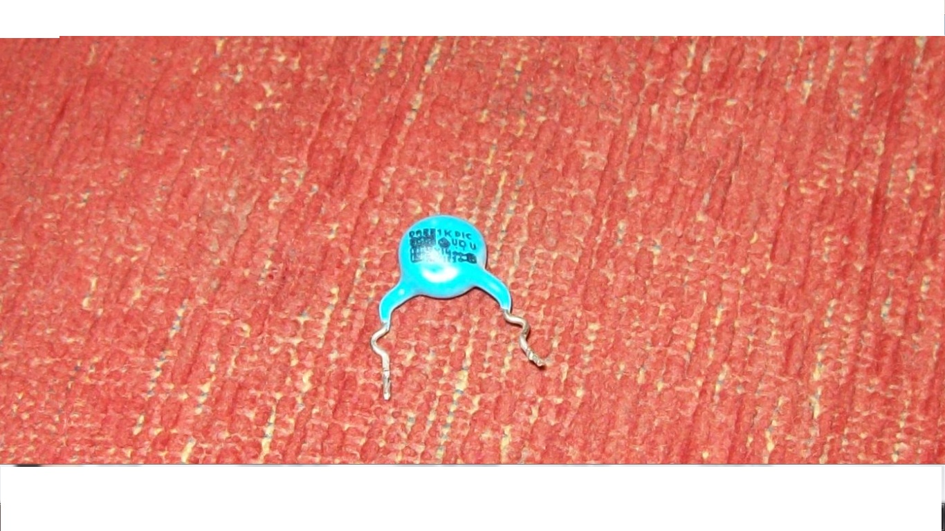

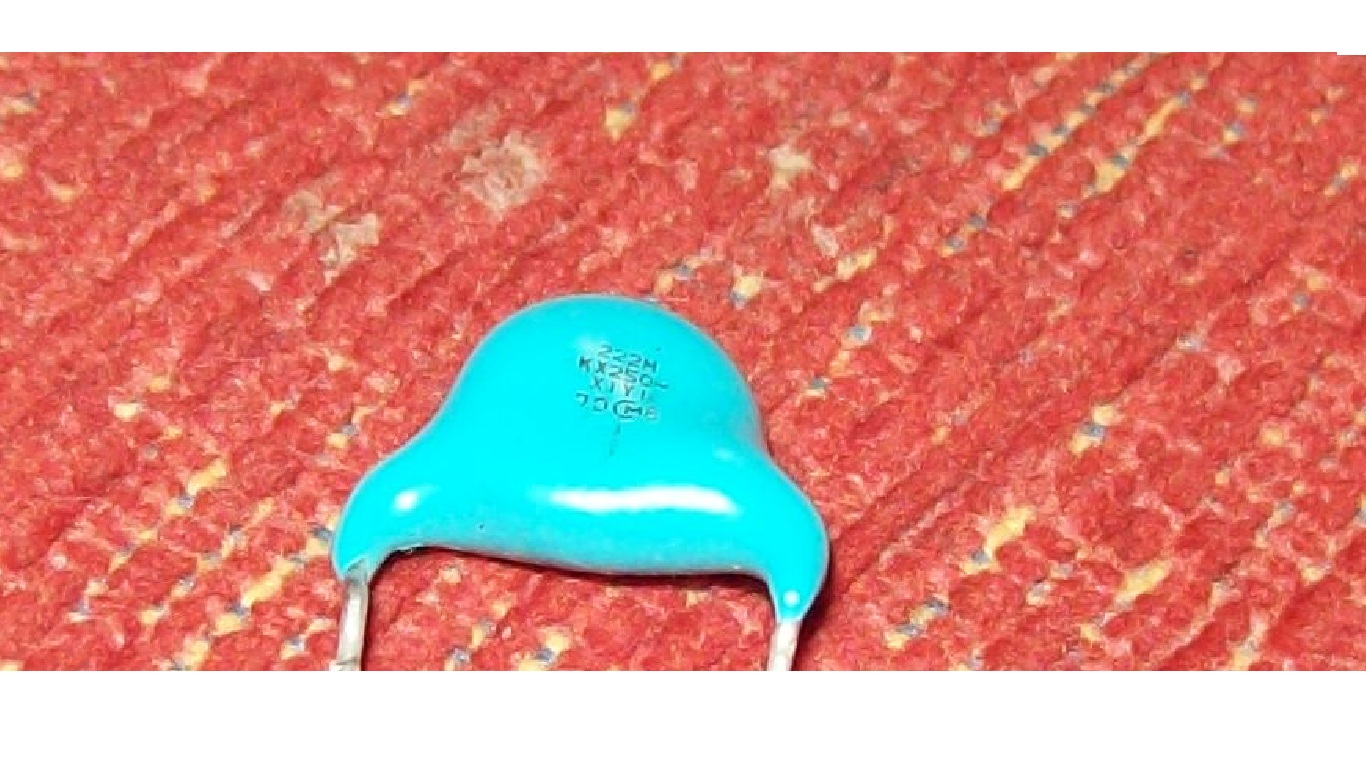

New here, have been repairing lcd tv's for a couple of months as a hobby, my brothers Beko got hit with a surge and keeps blowing the t3 fuse board num xla194-03, the only thing i have found wrong are two capacitors that are not showing anything on the multimeter, problem is i can not make out what type they are. Any help identifying them would be much appreciate. Thank you in advance

The one on the left has a 1K on it so I would guess a 1,000 pf ceramic cap.
The one on the right is a 2200pF ceramic cap.

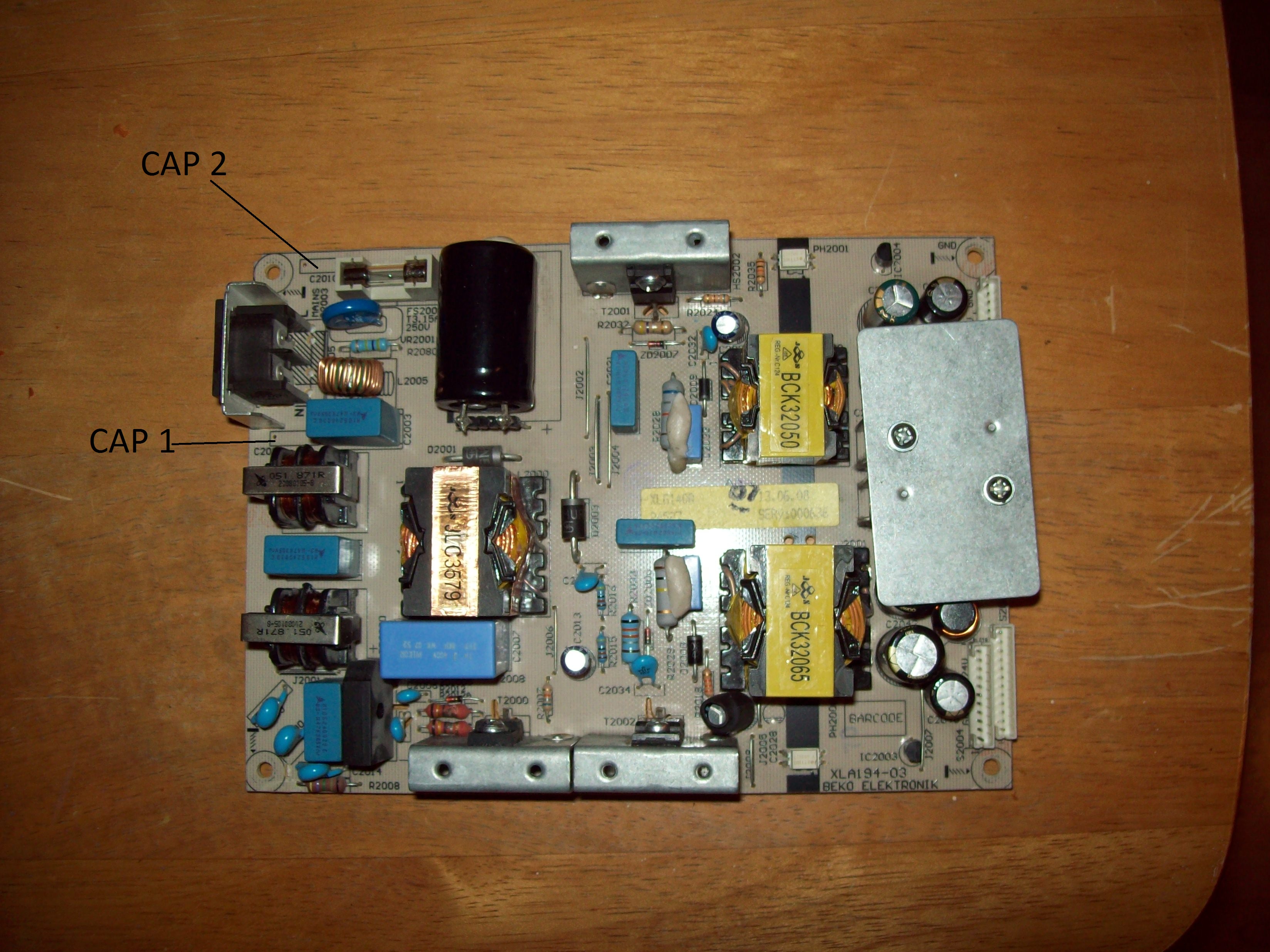

Thank you for the reply, i have attached a picture of the board below :)

Ah, OK, the silkscreen does indicate the locations as being caps, where RMMM offers possible substitutes.
The MOV in the pic, which normally takes the hit from a surge, looks to be vr2001 (the blue disk-like component below the fuse).
IIUC, the MOV should not show a resistance and this is possibly the reason for your fuse blowing.
Again, I hope someone more familiar with the operation and testing of MOV's can clarify.....
Then i will swap it out as well, might as well have to go get new caps anyway :) thank you for your help
The MOV should show INFINITE resistance. If you test it with a continuity test and it says it there is continuity... Thats bad.
They are rated for at least 200ish volts. If the 1 volt from the continuity test shows true, it NEEDS to go.
Hey, on continuity test its coming up @ 1.352, no buzz though on omhs test 0.46, is that bad?

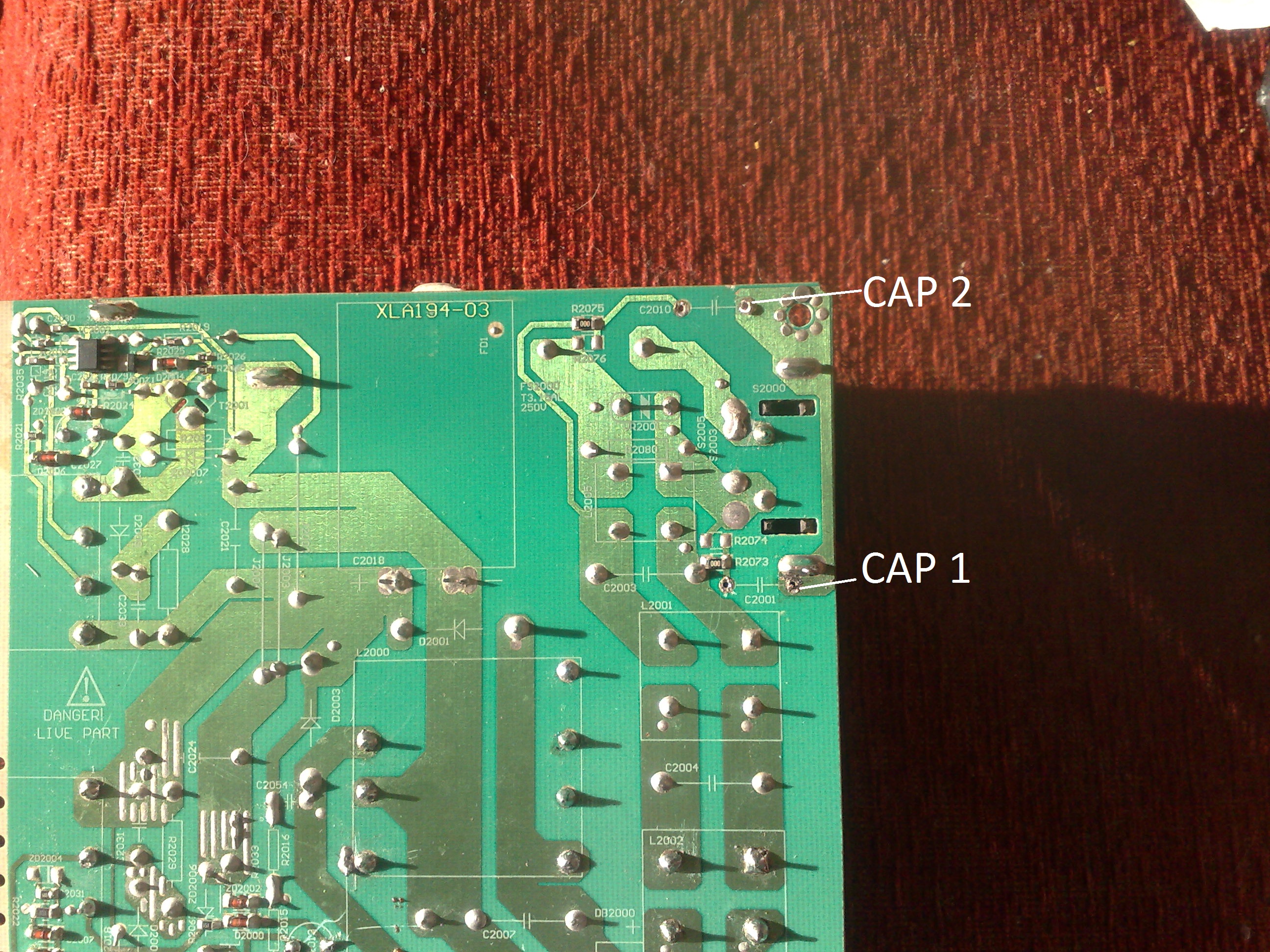

One more q, attached is a pic of the back of the board, the two caps that seem to be broken seem to be connected to the earth in the corner, would that be been the problem? Thanks again

The ones labeled ZD are Zener Diodes.
Look in google images to see if they look different that the same style that are new, or known good.
They look fine to me, but I cant see them that good.

I could be wrong and it could be a coincidence but looking at the picture in post #5 at the bottom towards the left the 2 resistors R2012 and R2012A look like they are fried.
Makes me wonder if fried resistors ever short out or just open?
Mike
In my experience the first two type of caps very rarely pop. do you measure any continuity (resistance)? The MOV definetely needs replacing.
