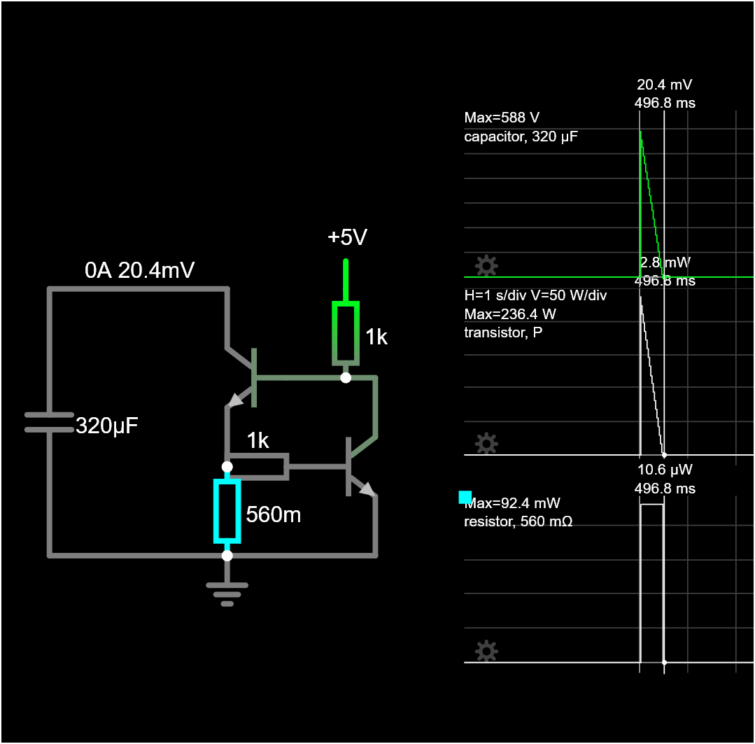

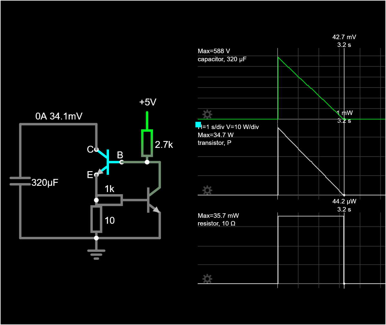

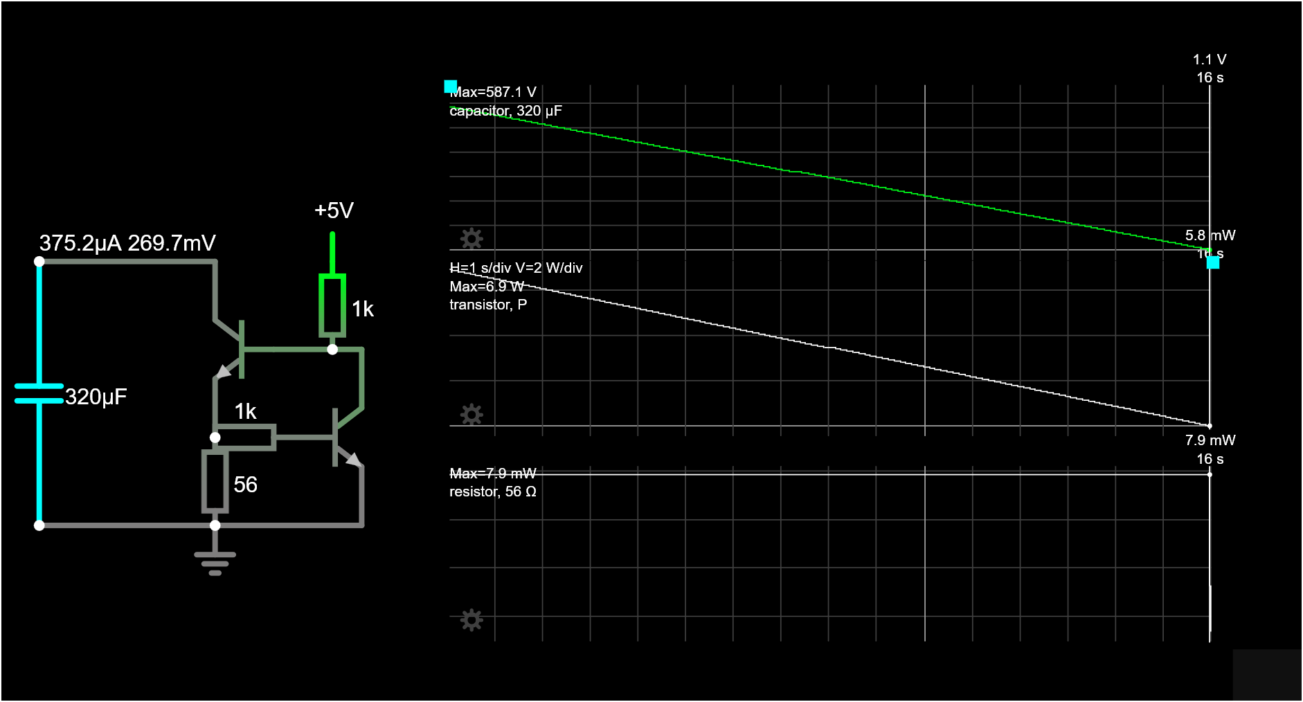

0.5*320 e-6 * 588^2= 55.3 J. How quickly must you drain the caps?
1 s ? 10 s?
I would use a constant current sink and choose max temp as 30 'C rise. < 10 s. A reasonably small CPU heatsink with a TO-220 can do this in 1 second if you want. Or a 25 W sink
sim : https://tinyurl.com/2a7b2hyf
Polyfuses tend to operate 120'C
1 s ? 10 s?
That is pretty nice. I'm guessing this is what Nigel Goodwin meant by an active discharge. I did not think of using a current source for discharging. Thanks for sharing as this is pretty interesting but rjenkinsgb made me realise that the operating temperature range referred to the ambient temperature range rather than the temperature of the thermistor itself in the datasheet so my original thermistor solution would work I think as long as I adequately protect the surrounding components from the thermistor's heat. Also the caps need to be drained in less than 5s.
I wouldn't be able to use your suggested circuit without modifications as the circuit I am designing needs to be able to handle the maximum voltage permanently without being fried. A TO-220 MOSFET/BJT constant current sink would fail pretty quickly if exposed to continuous voltage hence my desire to use a PTC thermistor. Thanks for the idea though I'll keep it in mind if I need to design a similar circuit in the future with less stringent safety requirements.
