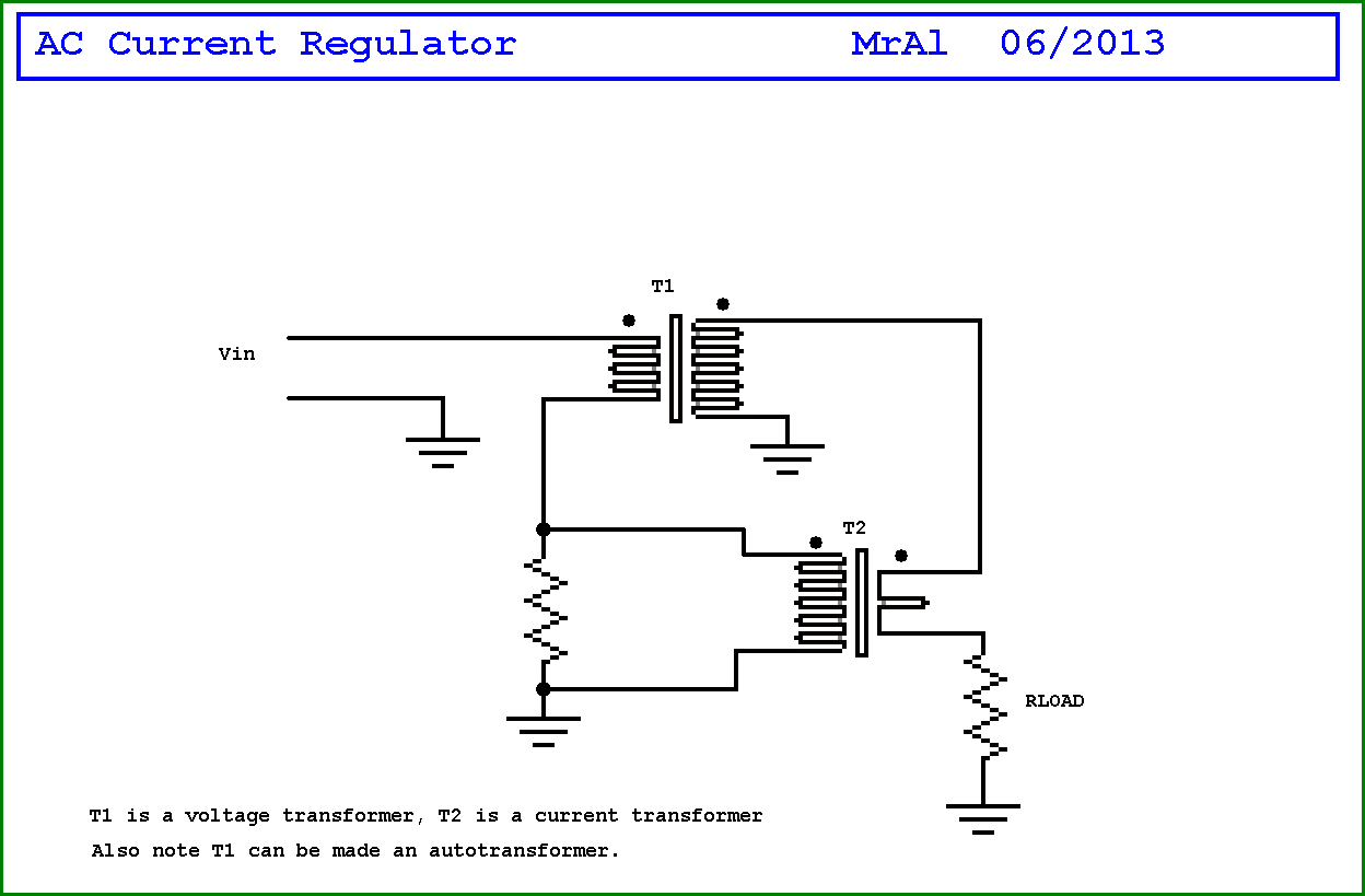

Here's a circuit that could work with low current in the load resistor. T1 can be a 'tapped' inductor if no isolation is needed. T2 also.
(Note that other resistor is usually called the 'burden' resistor for the current transformer)

Could work? Does it or doesn't it?
Without some description of the circuit parameters it's difficult to analyze. Will it work with any transformer ratios, primary and secondary inductances, coupling coefficients, etc.?
Hello,
Well i dont always include everything about a circuit, sometimes i just preset the basic approach and then leave the design details to the end designer. The most important part is the topology, and if the topology makes sense to the reader they should know how to proceed. But i could provide a few more details as well as an example i guess. I'll see if i can get to this tomorrow sometime.
