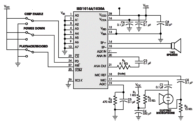

Can someone Draw the schematic for this picture?
shuluke
Hello,
Me and my buddy wanted to make one of these out of scratch, could anyone draw me a schematic of it? I want to make use of all the buttons in my car that dont have a function. Here is the picture.
Shuluke
ok, from the picture you have given, it would take a phycic to work out how the circuit goes. If you had a picture of the other side of the circuit board, we might stand a chance.
However, IMHO, the chip looks like a microcontroller. This means that we would need to work out what code to program it with. This means we need to know what the circuit does.
If you have a picture of the other side of the board it would be very helpful, and if you could tell us what it does (in a reasonable ammount of detail), that would also be very helpful
Tim.
Edit: Sorry if I sound rude, but we really do need a bit more to go on, unless anyone happens to recognise the circuit in the photo, which isn't that likely.
P.S. is this a photos you have taken, or is it one you found on the net?
Going from the silkscreen legend on the board, I presume it's a voice recorder chip?. All you need to do is download the datasheet for it from the manufacturer - that should include a suitable circuit.
You were right, there is a schematic with the manual. This is for a voice recorder. My friend thought it would be cheaper to build it ourselves than to find one and buy it. We only need it to record 5 seconds or less instead of 40 seconds like the one pictured, but also be able to play the clip over and over. When building a voice recorder, do you need to program the chip? Maybe someone has a schematic of a voice recorder allready and wouldnt mind explaining it? We want to connect it to the car, so when the alarm is deactivated, it will say something. We havent thought of what exactly we want it to say... but we will figure something out. There are also alot of "ricers" in the area, and we also want to make a fake BOV. We would make a circuit that when a button is pushed it makes that sound of a BOV. It seems like another application of the voice recorder/player. Anyone with ideas/suggestions? thanks for the help

shuluke, I don't want to be rude either, but your question combined with the picture has some problems a schematic won't solve. You'd like to reverse engineer the product, right? The chip is a bucket-brigade type analog recorder/playback device. It may be an application specific device with a built-in microcontroller (meaning locked & hidden firmware). Unless you have a source for this specific part, forget it. (the rest of the components on the board are easy to find)
other voice recorder chips
Digikey used to stock some inexpensive voice recorder/playback chips, but I didn't see any in their latest catalog. Maybe worth a search. Another option is an analog->digital => EPROM (storage) => digital -> analog circuit. It's more complicated, but can be made with commonly available parts (programming the EPROM can be a roadblock, though). I've seen these around on the web, and will post a link if I find one. The standalone voice recorder chips are a better choice, if you can find a source.

With the voice recorder, we wanted the car to say something when we disarm it. So maybe it only needs to be recorded once, then wired into the car alarm so when the car is disarmed it says "disarmed" or something. Or when you turn the car on, it says "welcome". I have a few buttons on my car alarm that i dont use, the remote start for example, that when i pushed that button, it will say "Protected by .... " or "Wecome" just something different. I think the best idea would be to go with something like a button.
that simplifies things. If you'd like to start playing around with micros, check this project out
https://www.romanblack.com/picsound.htm
It's pretty basic, but may be all you need. There are some other nice ideas & projects on that website as well.
On the picture i see the original chip from International Storage Devices (ISD). Today ISD formerly Winbond. ISD1016 the most cheaper version of family with 16sec record capability.
Just got a look at the photo ... the chip in question is made by Information Storage Devices (ISD) and it's part number is ISD2540P.
Here's a link to a datasheet I found at www.datasheetarchive.com:
This datasheet should tell you everything you need to know about using this chip. JB
