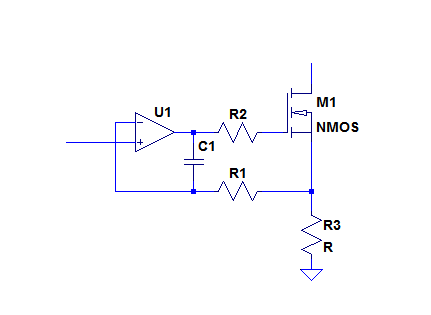

Oh, one more question. Regarding the previous circuit example you said the circuit might oscillate because of the "big honkin mosfet loading the op amp".... what's the difference between that the the M1 of your circuit? Is there a larger gate capacitance or something?
Gate capacitance is the potential problem. M1 is a small-geometry part, so it has low gate capacitance. Gate capacitance is not an impossible problem to overcome. It basically just requires an extra resistor and capacitor.

So what causes the oscillation? Is it because the op amp is trying to regulate the current through the mosfet, but the mosfet is too slow to react?
Many (most?) op amps don't work well into capacitive loads. The cap adds an unwanted pole to the feedback loop, causing excessive phase shift and making the loop unstable. The problem can sometimes be solved by adding a zero in the loop to (partially) cancel the pole. If you haven't studied control theory, this probably makes no sense.
