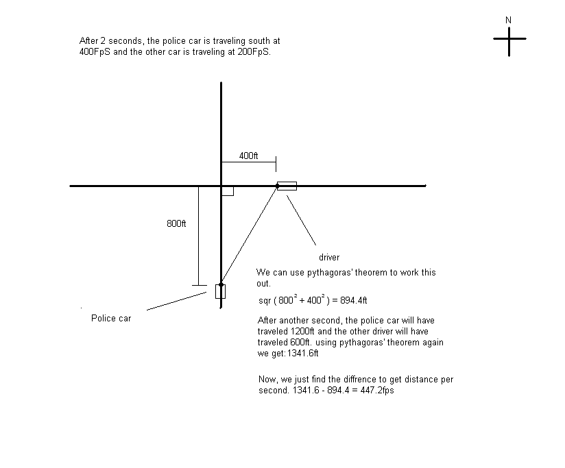

Is this not just simple pythagoras' theorem?
Hi daniel,
You can approximate it using a technique like that but you need
to get a few things straightened out first.
One is the cop car starts out 200 feet NORTH of the intersection,
not right at the center of it.
Second, in order to approximate like that you need to take a
smaller increment in time. Say, 0.001 second instead of 1 full
second.
Try these two corrections and see if you can come up with
the same answer.
You can offset the answer quite easily.
sqr ( (800-200)*(800-200) + 400*400 ) = 721.1102551 feet apart. at 2 seconds.
sqr ( (800-200+(400*0.001))*(800-200+(400*0.001)) + (400 + (200*0.001))*(400 + (200*0.001))) = 721.5540174 feet apart after 2.001 seconds
721.5540174 - 721.1102551 = 0.4437623 feet more distance after 0.001 seconds
0.4437623 / 0.001 = 443.7623 feet per second
Hi again Daniel,
Ok, you got the answer more accurate now, but notice that the
policeman is moving away from the suspect at t=2 seconds?
Since it doesnt make much sense for him to do that, and the
other answers were coming out to around -316 ft/sec (which makes
sense because then he is catching up to the speeder) we had
figured that there was a mistake in the statement of the problem
in that the 2 seconds (two seconds) was really 0.2 seconds (two tenths
of a second) instead and this would make more sense.
The approximation you are using though is still the time derivative,
and is actually the definition of the derivative and is often written
like this:
f'(x)=lim[h->0]((f(x+h)-f(x))/h)
or for h very small is approximated like this:
f'(x)=(f(x+h)-f(x))/h
But for numerical computations it is often approximated
like this because it gives more accurate results:
f'(x)=((f(x+h)-f(x-h))/(h+h))
where again h is kept small like 0.001 or something like that.
The exact derivative for a quadratic isnt hard to find
however:
for
f(x)=2*x^2+15*x+3
the exact derivative is:
f'(x)=4*x+15
This is found by taking the derivative of each term one
by one:
f'(2*x^2)=2*2*x^(2-1)=4*x
f'(15x)=1*15*x^(1-1)=15*x^0=15
f'(3)=0 (derivative of a constant is zero)
and then putting them back together:
f'(2*x^2+15*x+3)=4*x+15
Since this isnt too hard to do we used the exact derivative, but
it does help to check the answer with the approximation.
If you like, try this again with t=2 seconds and t=0.2 seconds and
see what you come up with.
Hey MrAl
You've completely lost me, as I am completely ignorant when it comes to calculus. The only math I know is mostly electrical.
0.2 seconds would make a lot more sense. Although I still get a different answer.
sqr (((0.2x400)+200)²+(0.2x200)²) = 282.8427125
sqr (((0.201x400)+200)²+(0.201x200)²) = 283.2670118
283.2670118-282.8427125 = 0.4243993457
0.4243993457 / 0.001 = 424.2993457 feet per second (they are getting closer)
Hi again Daniel,
Well i dont know you seem to have done pretty well in coming up with
the idea in the first place! I think you almost got it too.
Remember the cop car is 200 feet north of the intersection, so this
has to be negative.
Try this:
sqr (((0.2x400)-200)²+(0.2x200)²) = ?
sqr (((0.201x400)-200)²+(0.201x200)²) = ?
and see if you can come up with the same answer, or close.
Also, since the time is so small now (0.2) it helps somewhat to
decrease the increment (0.001) to 0.0001 as this increases accuracy
a bit. If you do it both ways you can get a good idea how this works.
Let me know how it works out...
