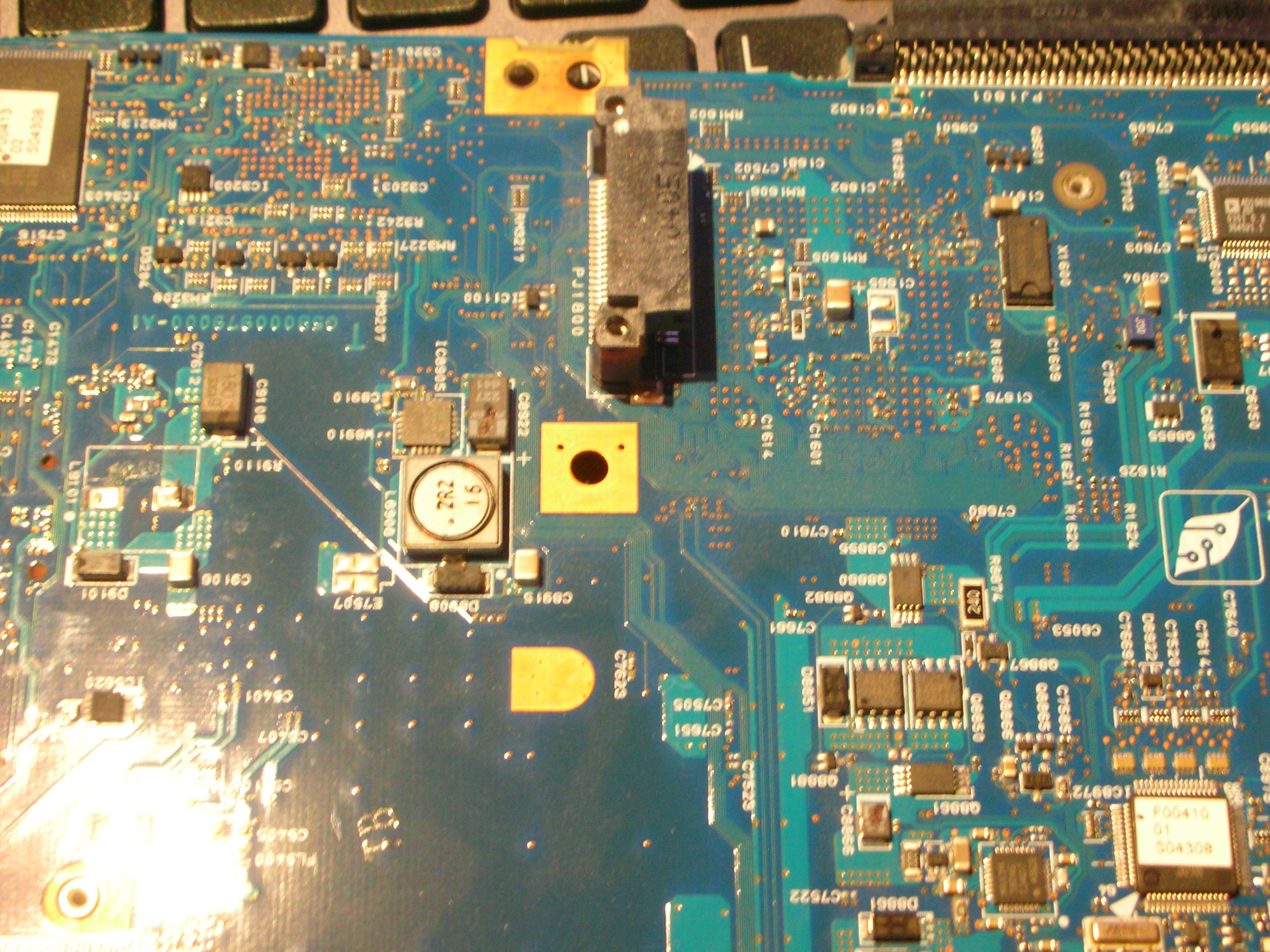

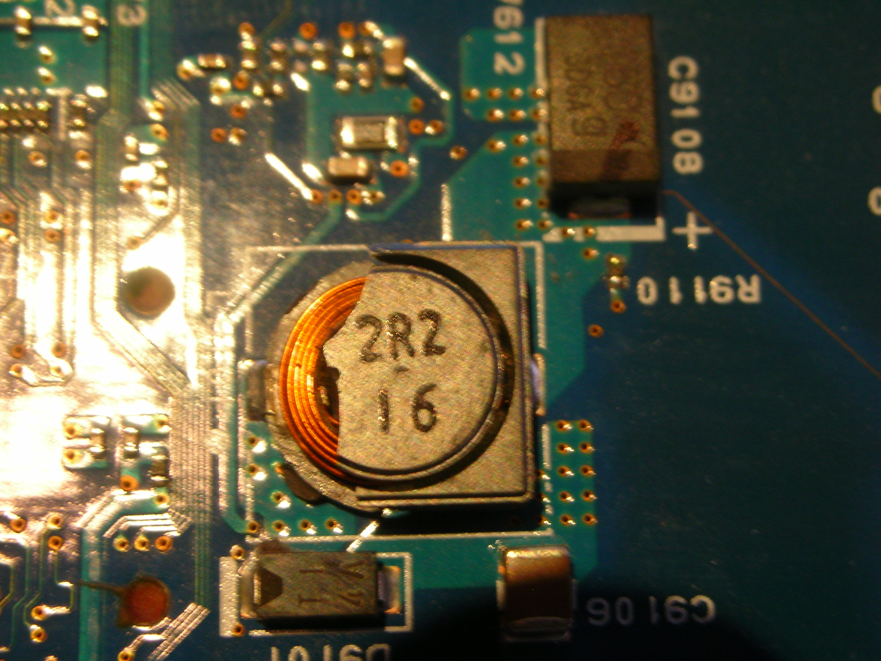

Can someone please tell me what this part is on my Laptop motherboard?
themastr
Hey guys
I can't seem to find this part on my motherboard. I'm not even sure what it is. Can someone please let me know and tell me where i can order this piece if possibly?
I think it's a resistor but where can I get one this type?
It's an inductor, probably 2.2µH.
As long as the copper coil part is OK, you could glue the broken bits back on if you can find them.
You could buy a new one here:
Digikey.

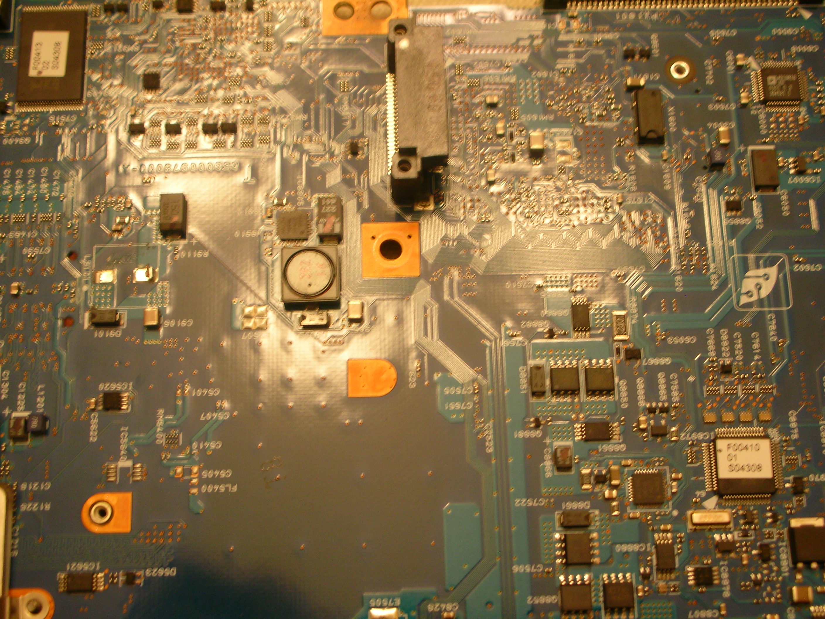

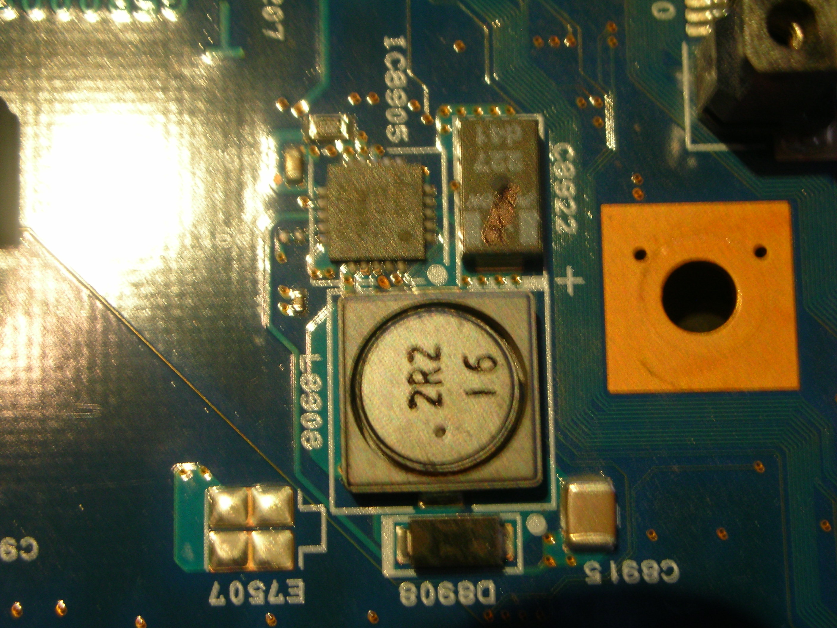

Now it gets more difficult. You need to accurately measure it's size so we can select one that will physically fit. After that we'll need to choose one with the highest current rating in that size range. Probably quite a few will work. We are really guessing here, so it is important to know where the coil is in the circuit. Are there any other ICs next to the broken one? If so, what is the number on it? ICs are parts with many (8 or more) legs. Maybe you could post another PIC zoomed out a bit by about 4x to what you posted.
Thank you for the help !!! Here are some more photos of the motherboard. Can you tell me which IC I will need to read?
In the first photo the Inductor was located on the top left side ( I removed it) there is an identical one right beside it. on the second photo you can see the identical one in the center and the pad mounts on the left hand side where the broken on was.

That'll probably work. I would order this identical one instead since there is no reeling fee.
There doesn't appear to be an IC close enough to be associated with it unless it is on the other side of the PCB. Looks like it may just be a filter choke and not the main inductor in a switcher. Before you go through the effort and expense of ordering it, make sure that nothing else was damaged. This includes the PCB itself. Look closely for small cracks in parts and the PCB around the impact point.
I will place an order and will let you know if everything works out.
