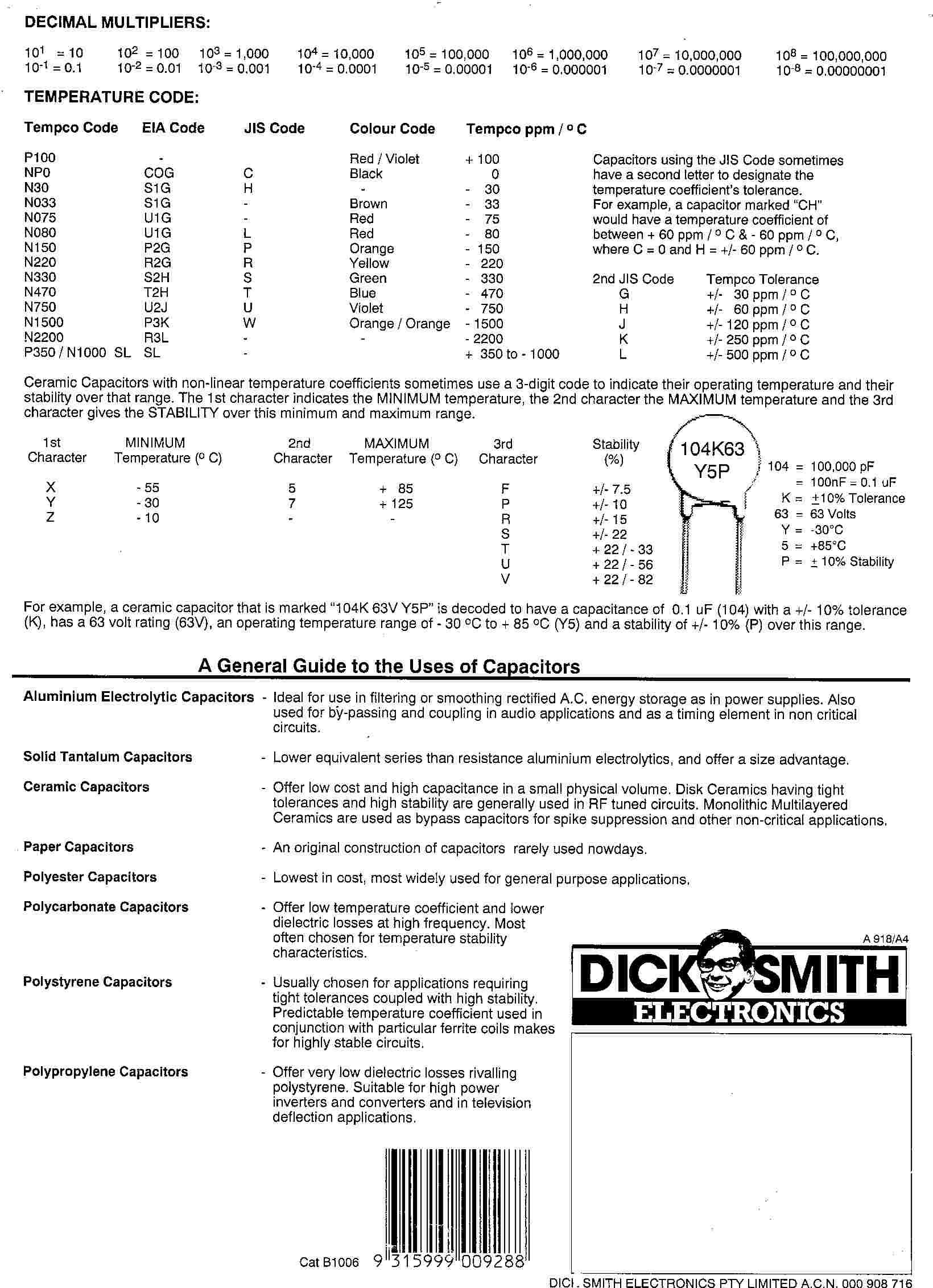

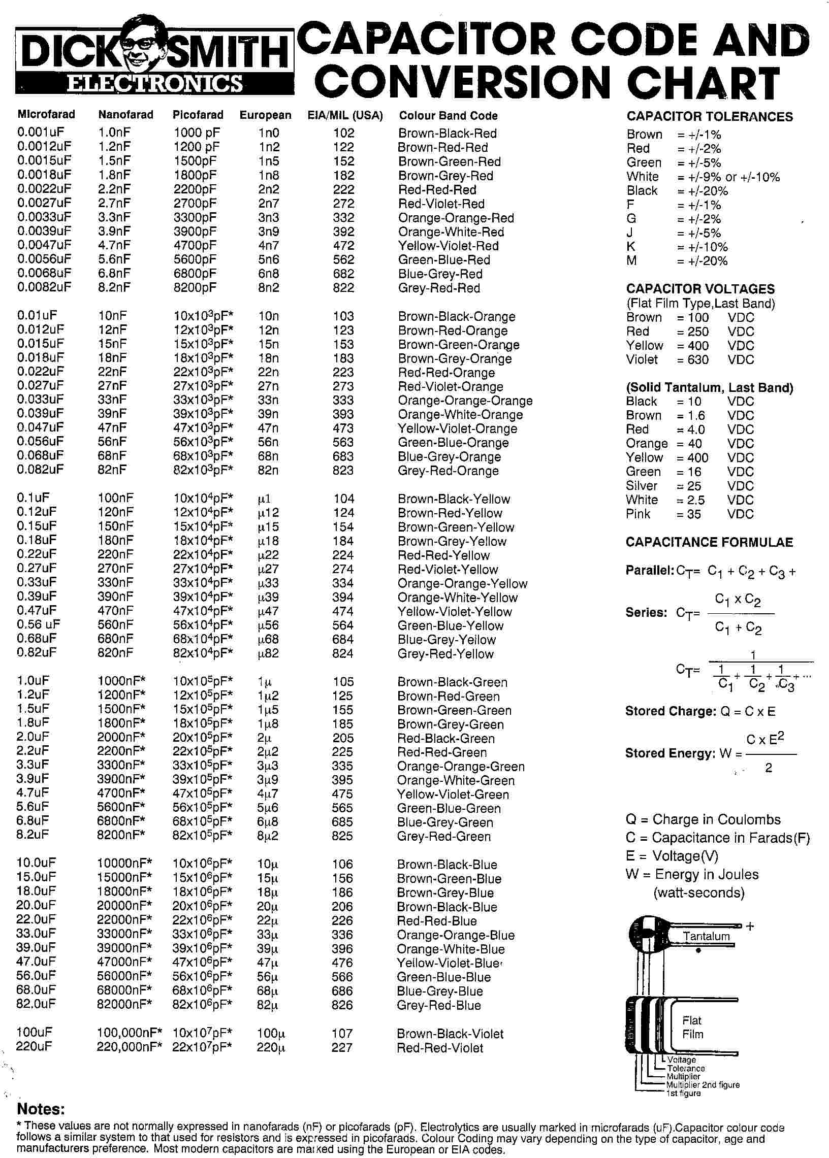

What do you guys make of the "84M" line? (Anything to do with value or temp coefficient?) I've got a bunch of these capacitors that have gone unused because I don't know to make of the value.
Hope this helps.
Very helpful! That capacitor guide is just what the doctor ordered! 8)
