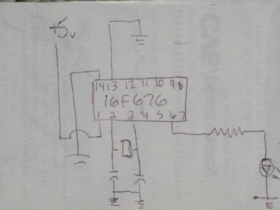

OK, here's the circuit.. its a 16f676 with a 4Mhz crystal .. I don't have any pcb type software so I just drew it up.. It works with a different program, only difference is I consolidated it all into one loop with a lookup table.. so, Im not sure I get whats happening...

Hey guys,
Thanks.. In my haste I forgot to add the M_CLR wire tied high. I downloaded a PIC simulator program that goes through the code and shows what all the registers are doing. I just ran the code and stepped through the first and second iterations and realized that the same value was being moved back into the W register after the lookup and thusly, the light wasn't doing anything but staying on the whole time. Aside from moving some lines of code around to look better anyway.. the line that I changed was
movwf tmp for whatever reason, this line just moved the registers address into W, 0x28.
to movf tmp,w
