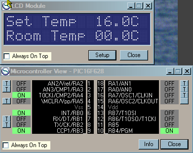

I ran the asm code from that link for the Thermometer project on my Oshonsoft Sim.
The program displays the startup labels OK on the Sim, see the image.

hi eric, your post was not a waste of time no, it does confirm that the code works for the type of lcd im using.
i am not sure at all where i have gone wrong, if the code simulator says it works then i suppose it should work in reality, but it doesnt.

You LVP the chip are you pulling pgm low to vss
You no you can't use that pin the pgm if it gos high it reset the chip for programming

The part in red is why your lcd is not working you can't use RB4 pgm
He won't be able to turn off LVP with a LVP programmer.
