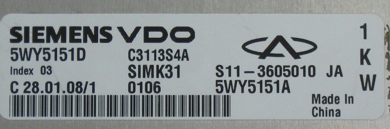

I have a 2008 Joyner Trooper T2 offroad vehicle with a Chery 1100cc engine and it has a Siemens VDO 5wy5151d‏ ECU ---From China-----

I talked to Brandon at Joyner-USA and he says our Joyner ECUs have a proprietary code, I guess that means the off the shelf, inexpensive reader won't do the job.
So now what, start buying parts that may or may not be needed? Maybe I ought go buy an new Trooper with the proviso that they through a reader.

Competition systems like dta and weber are aftermarket ecu's, the kind of thing you put in your car when you want to tune it up, competition systems are designed to be tuned with a laptop, whereas manufacturers systems are pretty much closed.
