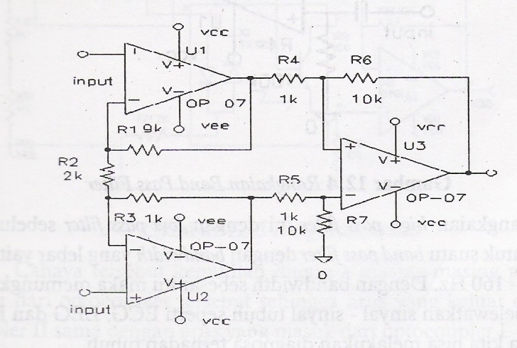

HI bro, I need help all of you to solve this problem. i can't analysis my circuit can you help me to analysis the circuit and how many part of circuit are there?

DC-coupled, high-input impedance, differential Instrumentation amplifier, with a gain of 50. Its output is AC-coupled to a gain of 10 non-inverting amplifier. Part of an ECG or EKG?
