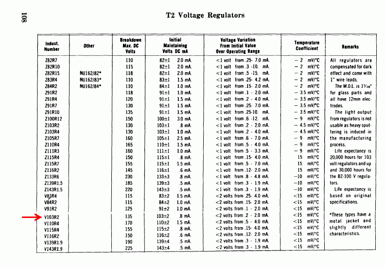

I have a Philips PM3266 with a fairly obvious fault in it's focus circuit; there is a burnt spot on the board where component V2078 ought to be. (see the attached PDF file) The part call-out tells me this was a V103R2 made by SL and the schematic diagram draws a very nice schematic representation of the part too.
The problem is I don't recognize the schematic symbol and I haven't had any luck referencing the nearly 30 year old part number either. Can anyone identify this mystery component? Better yet, can anyone suggest a suitable replacement?

T2 Voltage Regulator 103 volts
See page 56 of this PDF
Wow, I'm impressed with the knowledge floating around here. It seems the closest I can get, that are still available, is a 0C3/VR105
Thank you everyone for the help.
Evan

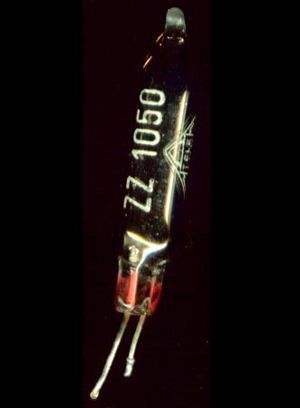

Hi Evan,
Is there enough room on the board for a "large" neon tube ?
Dimensions of the glass (of the ZZ1050) are 29 x 6 mm.
There are several possible candidates but there is only one in the
1972 Philips pocketbook that fits this description:the ZZ1000.
But there are also several lookalikes:
https://www.qsl.net/dl7avf/roehren/stabis.html
on1aag.
