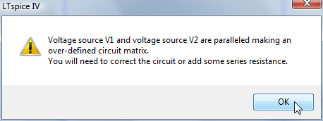

That circuit will blow up since there are two voltage sources in parallel. The higher voltage source will generate an infinite current through the lower voltage source (in theory).
The circuit as drawn is ridiculous.
Unless the voltage sources have some internal resistance which is not shown in the drawing, the set-up is impossible in both theory and practice.

The solution and correct response would be:
Wasn't that simple?
