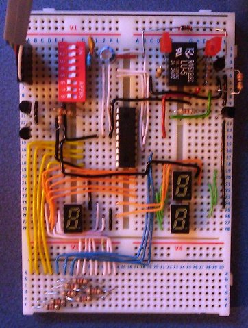

Hi all,
Can anyone help me out with this? I'm sure it's a simple thing for someone who has done this before. The datasheet is a bit scarce on information regarding TIMER0. Basically, I want the 'main' code to run as normal, and then after a TIMER0 interrupt, I want to run the interrupt code. Timing and prescalers are not so important at the moment, I just want to be able to get the interrupt. Here is the code:

Basically, the PIC spends most of its time on the three LED digits, and then on TIMER0 interrupt triggers the relay on.
Is there an advantage to using TIMER2? I have no preferableness, as I have not programmed timer interrupts before.
Input is most appreciated, as always...
-Johan

I think the interrupt is working as expected but you don't see the change on port A as your main code is writing to port A as well.
You should also think about saving and restoring the context in your interrupt. See section 14.7 of the data sheet.
Thanks Pommie. I modified the code, so not to write whole PORTA, thanks for spotting that :)
However, unless I 'infinite loop' the program in the interrupt code, nothing happens. I know the interrupt works now, but if I let the program return from the interrupt, PORTA,0 never goes high??
Would that affect how PORTA is written to? I wouldn't expect Bank-bits to change, and W I don't case about...
If you have a large load (an LED without a resistor) on PORTA.0 then the other bsf in the main code will clear it. To find out if this is the problem remove all writes to port A in the main code.
As for the context stuff, it won't have any effect at the moment but as your code gets more complex it will cause problems.
Turned off PORTA writes in my main, and now the relay turns on.
PORTA,0 is connected to a 2N3904 transistor via a 820 Ohms resistor, which sinks current out of a Rayex LU-5 relay to turn it on. This must be sinking too much current out of the port then.
I would never had expected it to be a HW issue.
Thank you Mike :)
PS: I'll take you up on your advice to save context on interrupt.
Changed the resistor on the transistor from 33 Ohm to 1.5k Ohm, and now it works perfectly.
I don't know why I used such a low value.
You have to be careful that you don't take too much current out of a port pin. The good news is that the problem is now solved and you can move onto the next part of your project.
