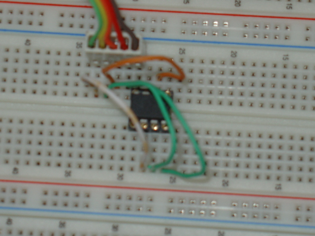

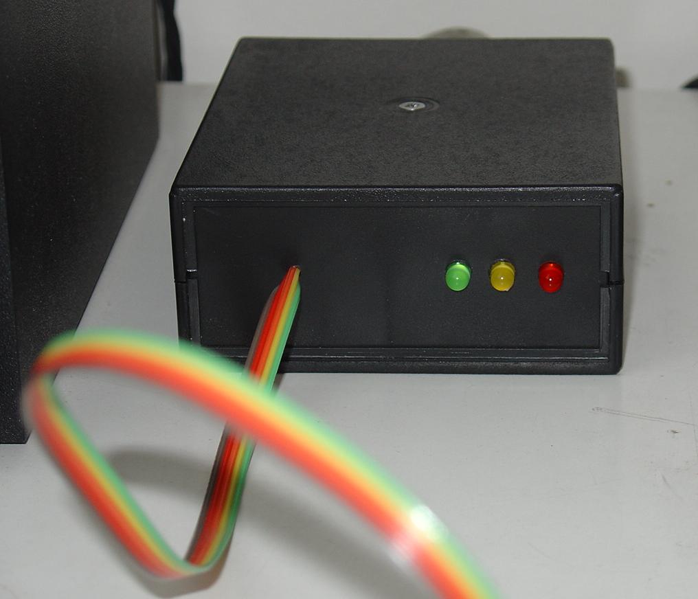

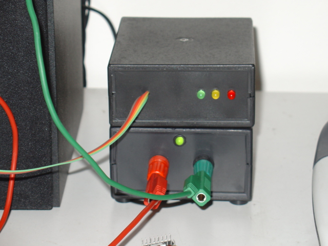

What a coincidence! I have been playing with my ICD2 and 16F675 all day today.... I had some strange 0x00 problem too. Then, after I re-read the Datasheet, I realised Swapped VSS and VDD in my design (strange, it's different at 16F628). After that it works like charm... Also check if you are not Overloading PGD $ PGC pins of the ICD2 (eg LEDs...).
williB said:
jay is that a cable with a sip connector on thr end..?
The one that is stuck into breadboard is standart 5pin Female+Male connector (SIP, like 3pin FAN connector), the other end is soldered inside the box/case..

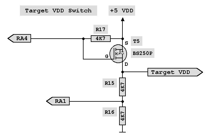

I just successfully programmed a 12F675 on my home-built Serial ICD2 but I included a circuit to effect ICD2 controlled Target VDD switching... I was hoping the ICD2 was smart enough to use "VDD first" and VPP first" methods for placing a target device into high voltage program/verify mode and so far I have not had any problems testing on a couple different devices with INTOSC enabled and MCLR disabled for Input...
I do get an ICD2 warning when I'm about to program this INTOSC/MCLR configuration into a target device but it programs the device fine, reads, verifies, etc., so perhaps this is simply not a valid configuration for In Circuit Debugging?
ICDWarn0033: MPLAB ICD 2 does not support programming this device if both the internal oscillator and internal MCLR are selected. You may continue programming, but you are encouraged to cancel, reconfigure your device, and try again.
Regards, Mike

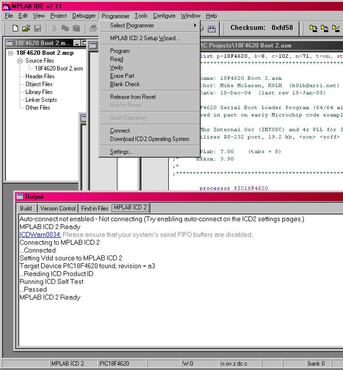

It's a remarkably unimpressive and only reasonably intuitive display in the form of a new tab in the Output window once you "bring up" the ICD2...
The ICD2 tab shows the commands you've initiated using the Programmer pull-down menu and displays warnings, process and command completion status messages...
After issuing a "Read" command from the Programmer pull-down menu, you have to use the View pull-down menu to look at the program or eeprom memory on screen, or you use the Configure pull-down menu to look at Configuration Bits or ID Memory...
If you load a new project with a different PIC and "bring-up" the ICD2 you'll watch it identify the target PIC and start "loading a new OS" into the ICD2 in the Output window...

Ok Willi,
Here's a screen shot...
Once you select a Programmer the Programmer pull-down menu opens up and gives you the commands you see here...
Let me know if you want to see more screen shots and I'll try to do some later...
