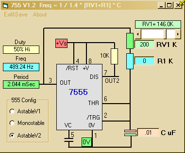

Look at this link
https://www.electro-tech-online.com/blogs/ericgibbs/125-simple-7555-cmos-timer-calculator-v1-2.html
Download and install as per the instructions, use Astable V2 for 1:1 square wave ouput.

So you used the 7555 calculator, any set up problems.?
No problems i just find that weird that breaking the connection to pin6 still gives me a frequency
