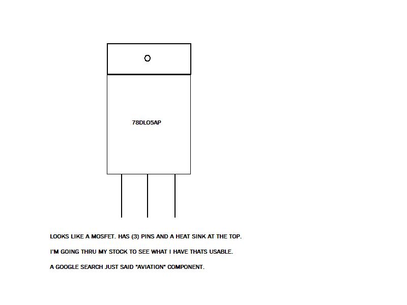

Cant find datasheet or info for: 78DLO5AP
I bought them in a lot with mixed components. I think they were used in aviation electronics, can anyone gimme the basics on them ? Thanks in advance, Jim
it could be a 5V regulator chip
you may publish a well focused close up photo, so that some thought can be put on it.
I cant get a photo til tomorrow late, but this is what it looks like.

This is what it looks like thumbnail didnt come up
Here is what I drew that looks like it

No Photo would be needed now. i am sure now it is a regulator.
If you study link below, it is evident that there are many devices in the same series
looking at the pattern, it is nothing but 5V regulator for positive voltages.
you can safely apply + 9 to +12V DEC at pins 1and pon2 (middle-common)
and you would get 5V DC at pin3 with ref to pin2. regarding current carrying capacity, if the the centre TAB is thick, it might take 1 amp load with tab mounted on a good heat sink
if the TAB is a thin sheet of copper, perhaps it could be 500mA version.
I found a data sheet "KIA78DL05F" (KIA motors)
The max current it can provide is 250mA. The "L" in the name points strongly to a low power device.
Try out max. current before use.

Thanks Boncuk !! for the information. othjerwise the OP would have tried loading 500mA if not 1 amp
Of course the device takes care of it/
Thanks everyone, so its like a small transformer but in electronic semi conductors its called a voltage regulator. apply 9V to pins 1-2 and on 3 I'll get a positive 5v...learn more and more every day
I have no idea what Im gonna use it for now maybe drive a 555 and 4017 strobing ten 3mm red led's ??? what does a small 3mm led draw ?? the heat sink threw me off, the other guy found data of max 250ma, thats not a lot at all..... JimΩ
where ever you use 7805 for electronic projects you can use this
incidentally
it can derive 5V from just a 6V battery as long as input doesn't fall less than 5.6V DC. only limitation the output current is less than 250mA
that really enough for many small projects and as regulator in power adopters that deliver low currents.
LEDs are current devices
you need to put a series resistor in order to limit the current
the actual current is to be checked from the datasheet
In general efficient 3mm LEDs can work well at less than 10mA, say 5 to 8.
