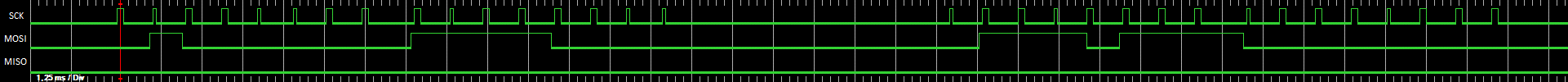

Logic ( SS( SDA), SCK and MOSI pins at the start of MCU ):

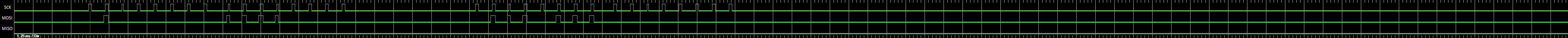

Full Logic ( SCK, MOSI and MISO pins at the start of MCU ):

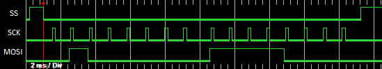

or (with immediate MOSI zero, to easier view)
As you could see, there's no answer from module:
Yes, PIC18F452 has special pins for SPI protocol (PORTC), but, unfortunately, I can't use these in this project.
All in all, no return from MFRC522_V register ( At the end an LCD is populated by " Version: 0x0" ).
Is a logic and communication itself right?

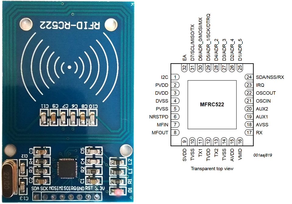

A module ( MFRC522 ):

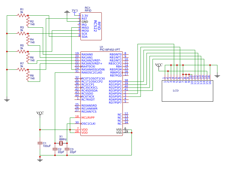

Schematic:
![8Sj7s.png](https://i.stack.imgur.com/8Sj7s.png)
An MCU ( PIC18F452 ) is powered with 5V, module is powered from 5V(DC) -> 3.3V(DC) converter and all logic pins ( SS(SDA), SCK, MOSI, MISO and RST ) are connected using voltage dividers ( 3K and 1K6 resistors were used ( because

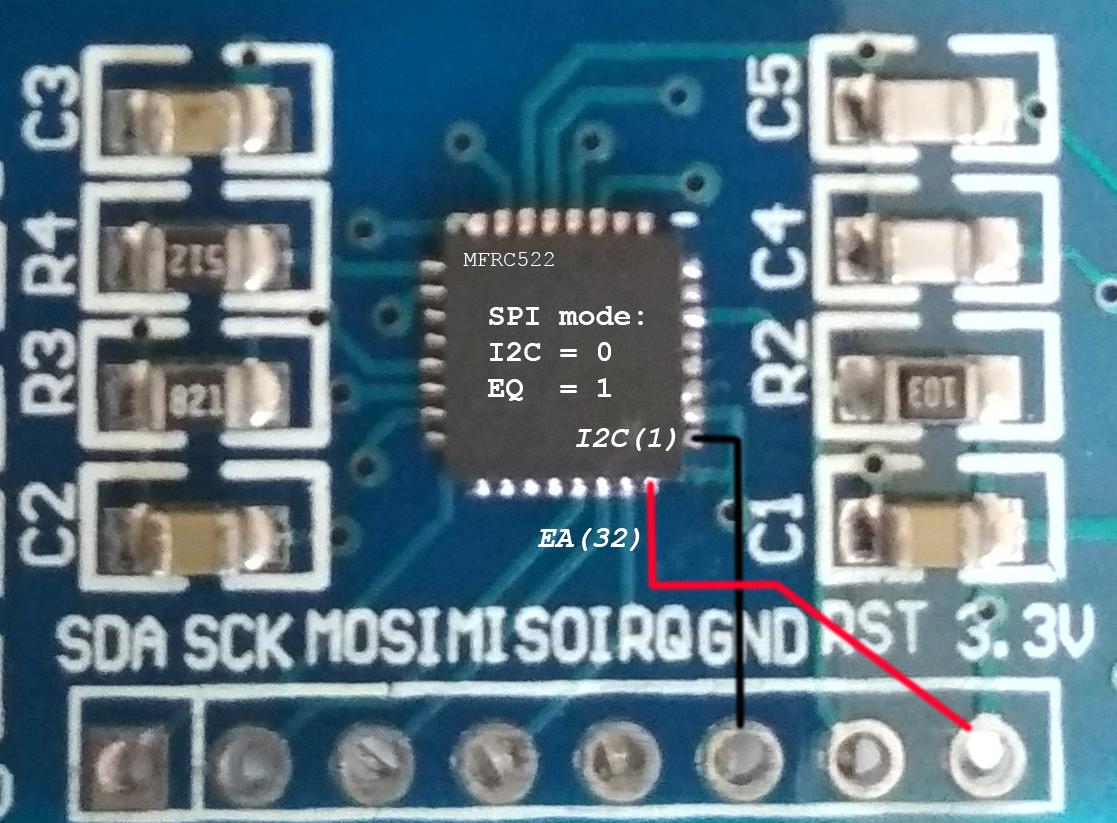

We know that I2C and EA pins of RC522 chip should be connected to 0 and 1 respectively to enable SPI interface mode for MFRC522 module as in datasheet is written (Table 5):
![ZyixM.png](https://i.stack.imgur.com/ZyixM.png)
I've checked with multi-meter and I2C is shorted to GND and EA is shorted to 3.3V so SPI mode should be ON, isn't it?
![p9EMy.jpg](https://i.stack.imgur.com/p9EMy.jpg)

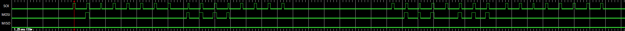

![yHWrz.png](https://i.stack.imgur.com/yHWrz.png)
![hTxWu.png](https://i.stack.imgur.com/hTxWu.png)

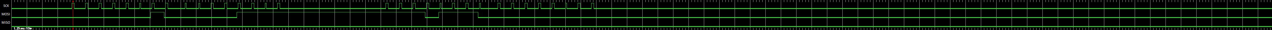

![dMcLw.png](https://i.stack.imgur.com/dMcLw.png)
![CSHlE.png](https://i.stack.imgur.com/CSHlE.png)

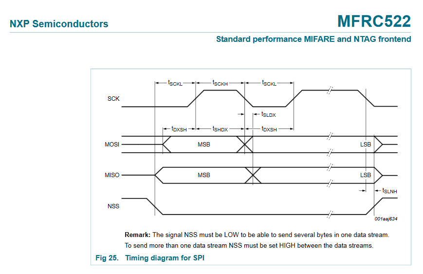

I've seen an interesting picture in MFRC522 datasheet:
![mUHcr.png](https://i.stack.imgur.com/mUHcr.png)
Does it show that byte should be sent from left to right rather than I've sent from right to left? For example, 0x63 should be sent as [ 0,1,1,0,0,0,1,1 ] rather than [ 1,1,0,0,0,1,1,0 ], is it?

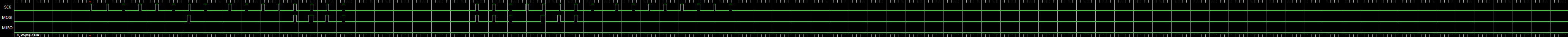

And the result in analyzer looks like:
![H3uX9.png](https://i.stack.imgur.com/H3uX9.png)
and with "immediate zero":
![wmt8g.png](https://i.stack.imgur.com/wmt8g.png)
As you could see, ... unfortunately, there's no result on MISO pin.
1. Do you have any idea why MISO doesn't have any data?
