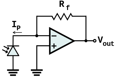

I basically tried this:
(SOURCE: https://i.stack.imgur.com/)
I've tried various resistor sizes ranging from 10MOhms to 100MOhms (10*10 in series)
+VSS 5V and -VSS 0V
+VSS 5V and -VSS 0V
I think that could be your problem.
Read the first couple of pages of the datasheet.
These op-amps require +/- 5 volts, ie 10 volts total supply voltage.
If you are using a unipolar power supply, ie 0v and +10v, the inputs and outputs should be referred to a virtual ground which is set to about +5v
As a simple solution to get you going, I suggest that you use a bipolar supply of at least +/-5v.
Try two 9V batteries for a +-9V supply. The output is inverting for the configuration shown, but you can flip the polarity of the input.

You may need to put a high value resistor in series with the + and - input. >10K-100K.

Common Mode Input Voltage Range. It is a little hard to read the datasheet but, The inputs do not work if the voltage is too close to the negative supply. They will not work at or near the negative supply. They need to be above the supply by about 2.5V. The inputs can run near the positive supply.
