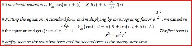

Hi All,
As some differential equation solving practise, I've been trying to derive the solution shown in a textbook on the left. Im trying to use ACos(wt)+BSin(wt) to solve for a particular solution, then later use Aexp^(Kt) later to solve for the homogeneous solution for the transient - is this the correct method? It's been a while since I've done these. However I'm already stuck and I'm not sure if I'm doing something wrong. I can already solve for the steady state response using phasors, but I'd like to try solving the differential this time and get in some much needed practise.
Thanks!

Megamox,
Do what the attachment suggests. Find the integrating factor and solve the equation.

Hi Ratchit, thanks for the help. I've managed to solve it with trigonometric manipulation, was quite exhausting.

Megamox,
Glad to help, but it looks like you are working yourself into a lather needlessly. The differential equation is a first order first degree equation that can easily be solved after multiplying the equation by the integrating factor. Any DE book can show you how. I believe you will find the integrating factor method much easier to to use for this type of equaton.
Ratch
Hi Ratchit, thanks for the advice! I've solved it using the integrating factor method below. The integration by parts was the most time consuming as I'm still a little rusty. Phasors has been so far the easiest, I think.

Megamox,
...I do understand the laplace method involves incorporating the initial conditions into the transform and so the result should be a total response, with transient included...
The Laplace method is the best way to go, but the DE must be linear.

Just for completeness, I've added the solution using the Laplace transform below. The partial fractions were the toughest part, almost as tough as the double integration by parts using the integrating factor method earlier.

Megamox,
You should be able to find the inverse Laplace directly from a table of inverse Laplacian transforms of moderate size without the need to do partial fractions.

Hi there,
It looks like you did a pretty good job there :-)
To show the beauty and simplicity of the Laplace Transform methods a little more, here is another quick approach when initial conditions are all zero...
We have a source Vm*cos(wt), and we have an impedance of R in series with L driven by that source.
The Laplace Transform of the impedance Z is:
Z=R+s*L
and the Laplace Transform of the source with Vm=1 is (Vm=1 for illustration simplicity):
Vs=s/(s^2+w^2)
so the current Is is just the source divided by the impedance:
Is=Vs/Z=(s/(s^2+w^2))/(R+s*L)
which simplified:
Is=s/((s^2+w^2)*(R+s*L))
so within a few seconds we've arrived at the basic solution.
And partial fraction expansion:
Is=(s*R+w^2*L)/((s^2+w^2)*(R^2+w^2*L^2))-(L*R)/((R+s*L)*(R^2+w^2*L^2))
and you can factor that any way you wish.
Partial fraction expansion isnt that hard once you do a few, but sometimes you'd have to have the numerical values of the components to proceed because the raw analytical form cant always be factored.
