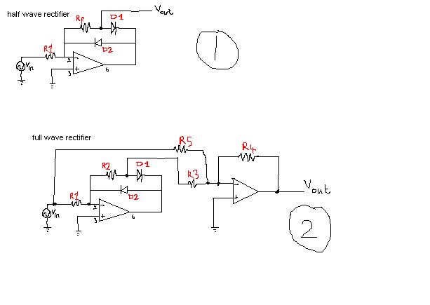

hi guys. im new to electronics so please bare with my dumbness. I have to know how the rectification circuits in the attatchment iv enclosed work. Iv stared at the schematics for ages but im confused. Please would somebody explain to me the overall operation of these 2 small circuits, like what resistors the currents pass thru, where it gets clipped, wat is happening etc. Iv looked in loads of text books as well to help me but im stuck. pls help.

Vin = input
Vout = Output
It seems with your half-wave rectifier, that you are depending on the diodes reverse break-down voltage to help you out. Without using Zener diodes (or equivalent), there is a 99% chance that the signal at the output of the opamp (operational amplifier) (point 6) will NOT go to Vout, unless Rf is a ridiculously small value, which in that case will make your "rectifier" just a plain resistor.
Because the non-inverting input (pin 3) is connected to ground, this amplifier runs as an inverting amplifier.
I think it is better to replace the diode connected between pins 6 and 3 with a resistor of at least 100K.
As for your full-wave rectifier, I think R5 can be omitted.
opamps tend to provide a ridiculous (I think) amount of gain, so you may get away with high or infinite feedback resistors.
that circle on the left represents the output provided from the last circuit.
There are others here that dealt with opamps more than me that can help you further.

MStechca,
The circuits are "classic" opamp precision rectifier circuits.
They use the open loop gain of about 200,000 of the opamp to effectively reduce the 0.6V forward bias voltage of the rectifier diode to nearly nothing, since the rectifier diode is inside the negative feedback loop.
Notice that the output of the halfwave rectifier circuit is not at the output of the opamp. It is at the junction of the rectifier diode and the negative feedback resistor so when the input voltage passes slightly past zero volts, the diode's output does the same in the inverted direction. A "perfect" rectifier with hardly any voltage drop.
R5 in the fullwave rectifier circuit can't be removed because it is very important for it to add the opposite polarity to the output summing opamp, making its output fullwave.

Full explanations about how they work:
Precision half-wave rectifier: **broken link removed**
Precision full-wave rectifier: **broken link removed**
