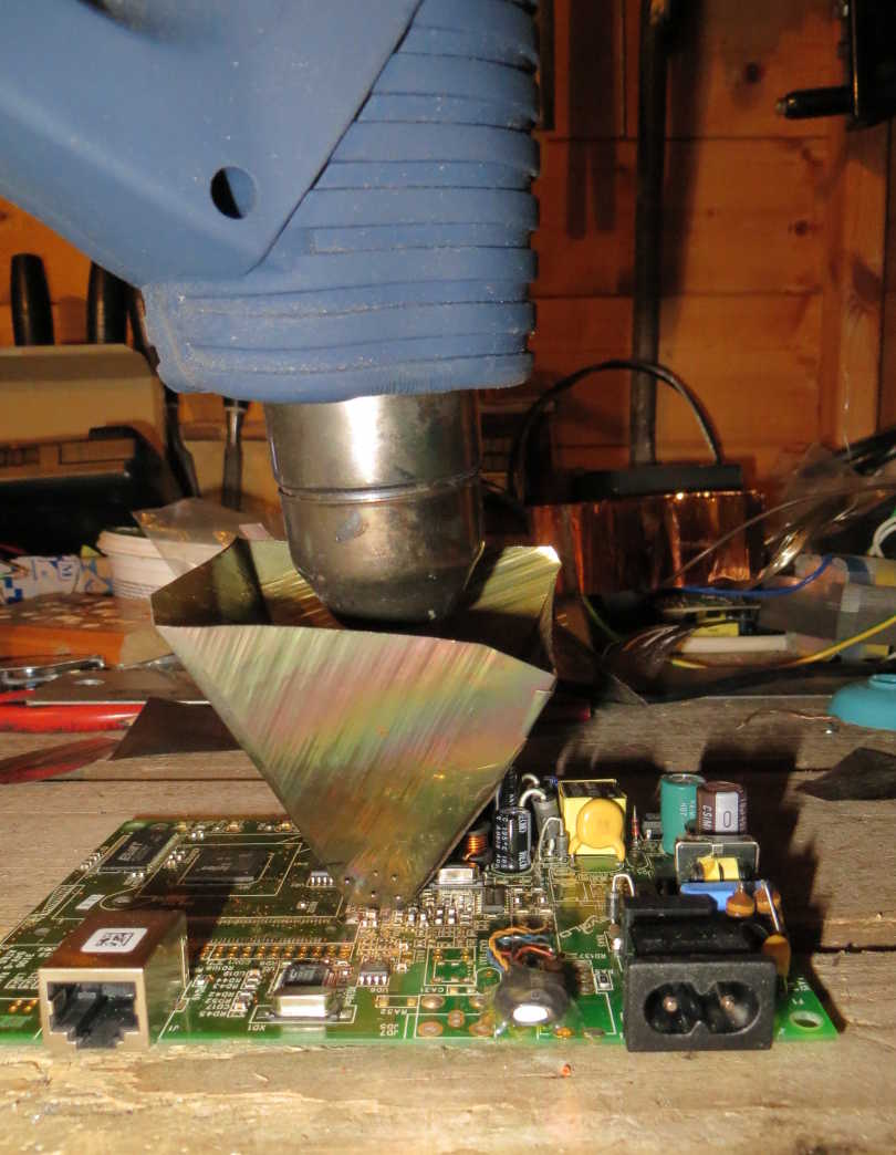

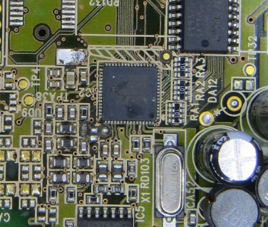

I decided to try to get the AD9865 off the Devolo board and try replace it. This is a 64 pin device in a 9mm square package with a thermal pad underneath. Damn thing won't shift! I made heat guide shaped like a kind of inverted pyramid with the point cut off, out of a bit of baked bean can, so the hollow point fits over the IC, directed the heat gun into the wide opening, watched a whole lot of nothing happening as I blasted hot air in. Tried making nail holes around the bit that fits over the IC, tried again, still no joy.
Tried without the heat-guide, all I managed to do was dislodge a capacitor, took me half an hour to get the damn thing back. Grrrrr.
So, any suggestions how to tackle this? A smd re-work station is out of the question! I need a process I can repeat to solder the new chip in - I do have some solder paste I can use for that.

Maybe I should make the pyramid thing more so it fits onto the heat gun, and has more vents in the sides? Then more hot air gets to the chip and not blown back over my hand...

Well, since you know it's bad, the first thing to do is CUT THE PINS. Then remove them one at a time.
With the thermal pad, you might have to heat from the bottom and possibly the top too. EPOXY really doesn't like to conduct heat.

You are on a hiding to nothing unless you apply good flux and gently pre-heat the board around the device from below to just beneath the melting point of the solder. The rework wand merely ramps up the temp to activate the flux and melt the solder on the device pins. The glue dots soften and become elastic at a lower temp, so once the solder is fully liquified, a gentle twist and lift motion is all that's needed to remove it. I know, easier said than done :)

I'm not sure cutting the pins is an option with this package - on the data sheet it's described as a "Lead Frame Chip Scale Package" - the drawing shows the connections being kind of underneath. Have a look at the photo, you can see devices next to it with actual leads - the suspect just has kind of bumps. And when I've de-soldered this one, I have the same problem again, soldering the new one.

I thought about heating from underneath, but I'm very wary of it because of the components underneath - I don't want to unsolder them! I think this (8 layer!) board is giving pretty good heatsinking too - doesn't help. Heatgun is such a blunt instrument.
The datasheet is here: https://www.analog.com/static/imported-files/data_sheets/AD9865.pdf. The package drawing is on page 47. That big thermal pad is the enemy.

Soldering it back in, you can use this https://www.proto-advantage.com/store/images/PRODUCTS/PA0096-S_0.JPG trimmed and re-flow it.

What it probably suggests is IR heating, such as this: https://www.amazon.com/gp/product/B...d_t=201&pf_rd_p=1535523722&pf_rd_i=B00C17YRLS
Yeah, that looks like it would do it! Lot of money I don't have. That's a nifty little mask - is just to spread the paste through?
I'll try making a different sleeve for the heat gun, but thinking it's just going to end up in the scrap box. Breaks my heart.
The "mask" is called a solder "stencil". The video on their website show how to use them, I just bought some protoboards from them which have to be modified before use. I have to split the thermal pad mechanically to be able to use it. I haven't done any stencil stuff yet. stencils don't have to be metal. They could be Mylar.
