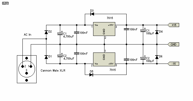

Hello guys,
just wanted to make a search via the net but unfortiunataly I had no clues and the needed keywords.
My problem is why those 100nF caps are there mounted in parallel with an electrolyt cap while the net result (Cx+Cy) is equal to the bigger one?
the other question is how to calculte thier values? (I am familier with Xc=1/2pixFxC) but tell me about the F and the XC for a circuit?
I have seen those 100nF caps used on the op-amps and the amplifier supply rails too, what about those ones?
The 100nf capacitors have a very low impedance at high frequencies where transients and possible oscillations can happen.
The electrolytic capacitors are good at low frequencies but are poor at high frequencies.
Thanks but what are those HIGH frequncies you are refering to??!
How to identify that freq you meantion to choice the suitable cap?

The datasheet has a part that talks about Supply Bypassing.
The LM3875 has plenty of gain at a frequency as high as 2.5MHz so you must use capacitor types and values that are rtecommended.
If you increase the value of the feedback resistors then the input bias current in them will cause a DC voltage at the output that you do not want. Also, the input capacitance of the IC will cause all kinds of problems when the feedback resistor values are too high.

Any load that has impulsing spurts of current can create stabilities issues to the feedback control system of a regulator.
Digital CMOS logic, for example, is basically switching capacitance around from logic '0' to logic '1'. Nearly all the current drain of CMOS digital logic occurs only during the logic transitions. This creates high current spikes at logic slew rate duration on these digital state transitions.
100 nF caps are often sprinkled around power pins on digital I.C.'s to provide the instantaneous current impulses, smoothing the resultant supply voltage ripple.

regarding those small caps, So If I have an square wave oscillator in the circuit oscilating at 100Khz so what about their values?
A 100kHz square wave has harmonics in its output up to 2MHz. A 0.1uF ceramic capacitor with short leads is good up to 2MHz.
