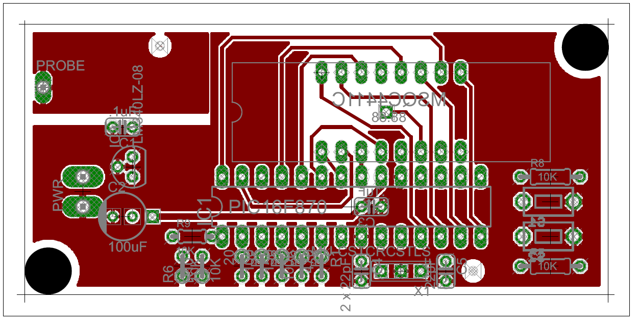

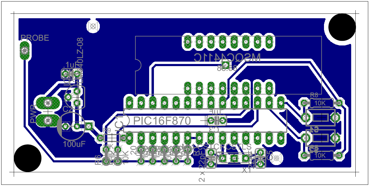

I am in the process of laying out a new PCB for the Mondo Superprobe. I have been attaching the tip/needle to the PCB by soldering it to a 10x20mm foil area on the board.
Will this corrupt readings? I am thinking that the foil would act less like a capacitor if there were no ground plain on the other side of the board. Is that good enough or do you think I should epoxy the needle to the board and do away with the 10x20mm foil?
EDIT: I have added png's of the top and bottom. This is my first attempt at this layout and there will be problems so do not try to build from it. I will be increasing isolate.

Capacitance is a few pF. Shouldn't make a big difference. I would minimize the area of the probe mount pad, but keep the ground plane under it.
To reduce stray signals on the probe node, however, I would move the probe trace to the red layer and extend the blue ground plane all the way under the whole length of the probe signal. You might have to reduce the separation rules from 'signal' to 'dimension' to get the continuity.
I would also move the power line on the red layer upwards, so you can get a continuous ground trace on the red layer inside of pins 1 thru 8.
On second thought, better than moving the probe line to the red layer, just make sure that the ground plane in red is complete on the outside of the resistors. This can be done by relaxing the signal to dimension rule.
Thanks. I was able to move the resistors closer to the processor and with a bit of work I now have everything you mentioned and a non broken ground around the edge of both layers.

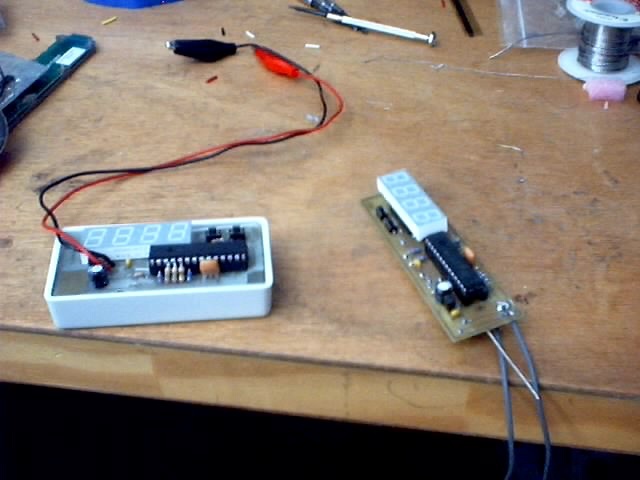

I want to make at least six of these in the next few weeks so the kids have them when school starts. The tip I have been using is a common needle (tapestry maybe) that the SO located for me. It has a point that can be used with a solderless breadboard.
This is a great tool for what it is. Some day.... I would like to build a better version. Go to a larger PIC to get more pins to work with. Better LC. Do something about the voltage measurement limitation. Switch to a LCD with text instead of the cryptic 7 seg words.
The long probe in the attachment it the version that I have been using for over a year. The one in the box is the first prototype for the one I am working on. It is a SS board but I have switched to DS because I needed to move the display and switches to the bottom.

One would have to try them. The Needle I am using works well enough for now. You posted while I was editing my previous post. I added a image that will give you some idea of the scale. The prototype does not have a needle mounted.
