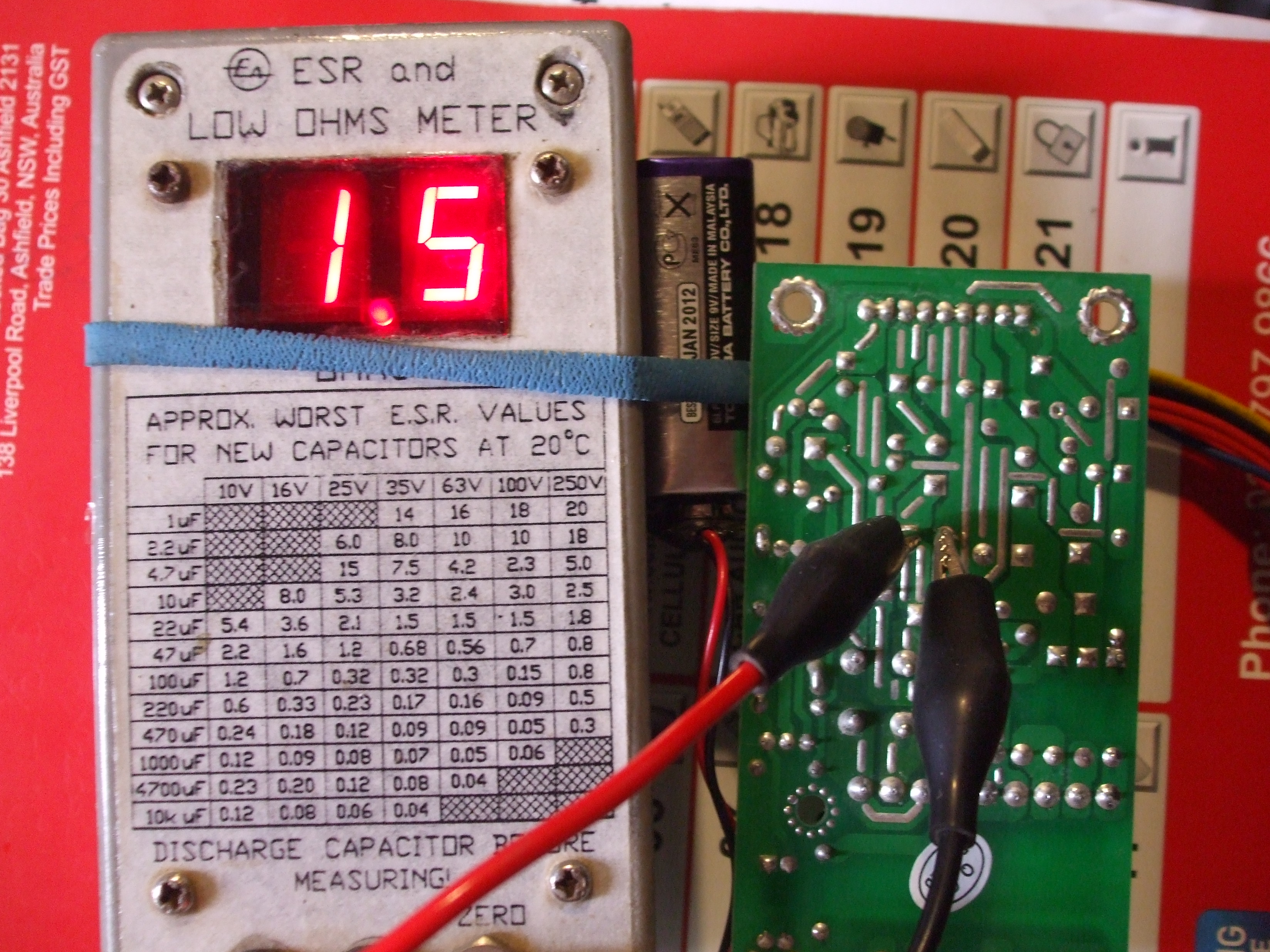

ESR meters are important to me & ive built & use 2. The grey one is the Mk 1 version & ive built the Mk2 version.
