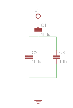

How do I calculate the capacitive value if there is a capacitor in series with 2 capacitors in parallel

Caps in series are like resistors in parallel. Caps in parallel are like resistors in series. Sounds strange huh?
You calculate the value for C2 and C3 in parallel. Then use the calculated value in series with C1.
This gives 66 2/3 µF :D

Yes, but he still have to calculate it and find out how.
Or no actually. I cannot say providing any number is really the answer. A real answer would being to tell the whole process (formula) to get to that number.
That's what I thought, (calculate the capacitance value of the two in parallel and then use that with the one in series)
Ran that through the calculator and I got 66.6u
