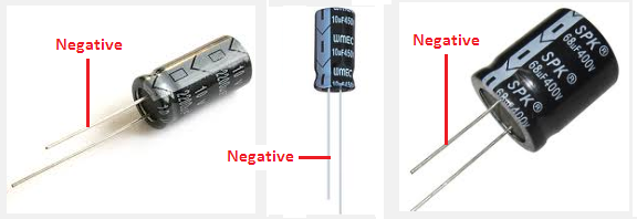

So i have this 640uF capacitor and its the last one,it's not properly marked or atleast its not marked according to what i'm used to_One lead is shorter than the other and there's a band around the position of that lead.
I know it sounds like a stupid question but always confuse these things and i end up blowing caps this time its my only one and i dont wanna blow it,so how do i connect it?
1) long lead to Vcc short lead to ground
2) short lead to Vcc long lead to ground
Ashamed
Simply look in Google Images like I did.
Modern capacitors have a minus sign and arrow on the side of the negative wire. It looks like the negative wire is the short one.

Connecting it to a 9v battery through a 10K or 100K resistor and monitoring the cap voltage after a few seconds may tell you the correct polarity with almost zero risk of damage.

Long lead +, short lead -. Just as beerbelly said.
Also, as AG mentioned, it should have a "-" sign on the negative side of the capacitor case.
