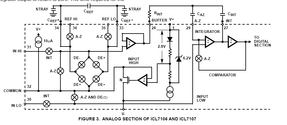

Whats the Difference between Capacitor Materials? Do each have a advantage or Disadvantage? For example, whats the difference between these 3 capacitors?
For My application, the IC requires certain Capacitors, such as Mica or Ceramic, Polystyrene, Mylar, and polypropylene. If Newark doesn't have one type of cap, can I substitute it with another? Will Performance degrade because of it? Im asking because I noticed they dont have Mylar Caps, nor do they have Polystyrene.
To help you further Help me; The OSC pin requires either Mica or Ceramic with a tolerance of 10%. The Ref pins require Polystyrene or Mylar with a tolerance of 20%, the INT pins and Auto Zero pins both need a polypropylene or Polystyrene or polycarbonate as 2nd and 3rd Choices. The Input pin doesn't say what type of Cap I need.
So thats why Im asking, If Possible, Can I use the "best" type of capacitor instead of all those? It would Make my order a lot more simplier, and probably save me some money. I know for a fact that I can use the Best lowest Tolerance Cap I can find, since in that aspect they are like Resistors. Its Just the Materials they are made of I am confused about.
For my application, Im using ICL7106/07 A/D Converter.

My take: use polyester for everything connected to the chip except for the osc and bypass lines - use some cheapish (X7R or better grade) ceramic parts for them.

Some more Info I picked up; ha for weeks I studied the data sheet and didnt think twice about reading these sections. I was off by 8Khz, The OSC req is 48Khz.
Integrating Capacitor
The integrating capacitor should be selected to give the
maximum voltage swing that ensures tolerance buildup will
not saturate the integrator swing (approximately. 0.3V from
either supply). In the ICL7106 or the ICL7107, when the
analog COMMON is used as a reference, a nominal +2V fullscale
integrator swing is fine. For the ICL7107 with +5V
supplies and analog COMMON tied to supply ground, a
±3.5V to +4V swing is nominal. For three readings/second
(48kHz clock) nominal values for ClNT are 0.22μF and
0.10μF, respectively. Of course, if different oscillator
frequencies are used, these values should be changed in
inverse proportion to maintain the same output swing.
An additional requirement of the integrating capacitor is that
it must have a low dielectric absorption to prevent roll-over
errors. While other types of capacitors are adequate for this
application, polypropylene capacitors give undetectable
errors at reasonable cost.

This circuit will also help:
circuit-jpg.8881
Following the circuit, It Seems that The Int Cap, and AutoZero Caps Come from the Analog signal input.
