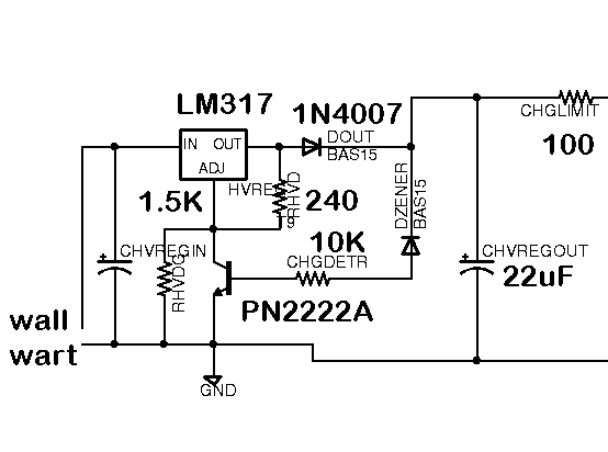

I then created a charger similar to this one except I replaced everything before C1 with a 12VDC/800mA wall wart. I also used 1.5K resistor instead of a pot and adjusted other parts accordingly.
This is what was confusing. my Capacitor C1 was 22uF and rated for 50V. Its about 5mm in size and has a label WH105 degrees. I then ran a test. I powered the circuit via the wall wart and I was about ready to measure the output areato make sure the voltage was right for my needs. About 5 seconds after the unit was turned on, capacitor C1 immediately popped. At first I thought I damaged the entire circuit, but instead, the entire can flew off (with the exception of the connecting leads) and a sprinkle of light grey was scattered in the area. It turned out to be feathery in nature.
So why would such a capacitor blow up when its voltage rating is significantly higher than the input voltage?
