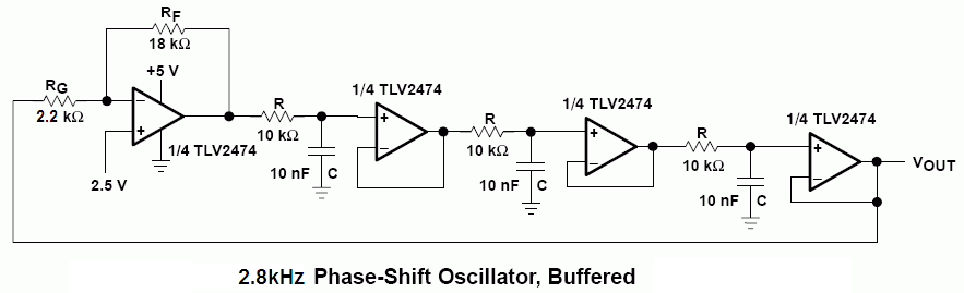

A "phase-shift oscillator" uses the 60 degrees phase-shift from three RC parts to oscillate. The RC parts also filter away the clipping harmonics from the first opamp so the output has low distortion.
