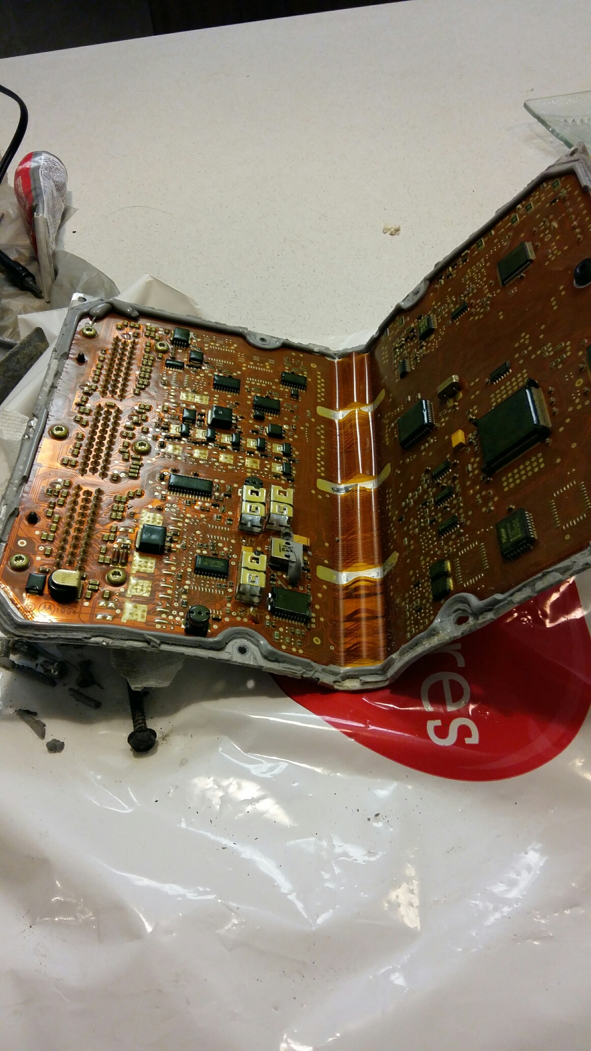

Hi all,
Sorry if this is the wrong section, but I have a very limited experience, but my ECU received loads of water last year, and my Jeep is having intermittent issues. I narrowed it down to the capacitors in the ECU wreaking havoc on the car. (Making the relays go nuts etc.. )
My question is.. I was able to take the three capacitors out, but I pulled too much on one, and I lifted a part of the board. (Please see attached)
Any help on knowing if there is a way to test if I can still go shead with the repair or not would be greatly appreciated.
Thanks!

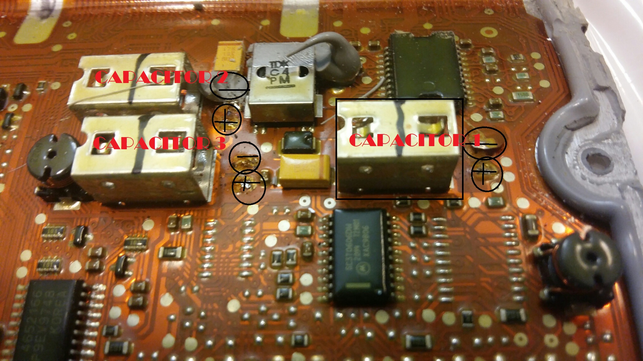

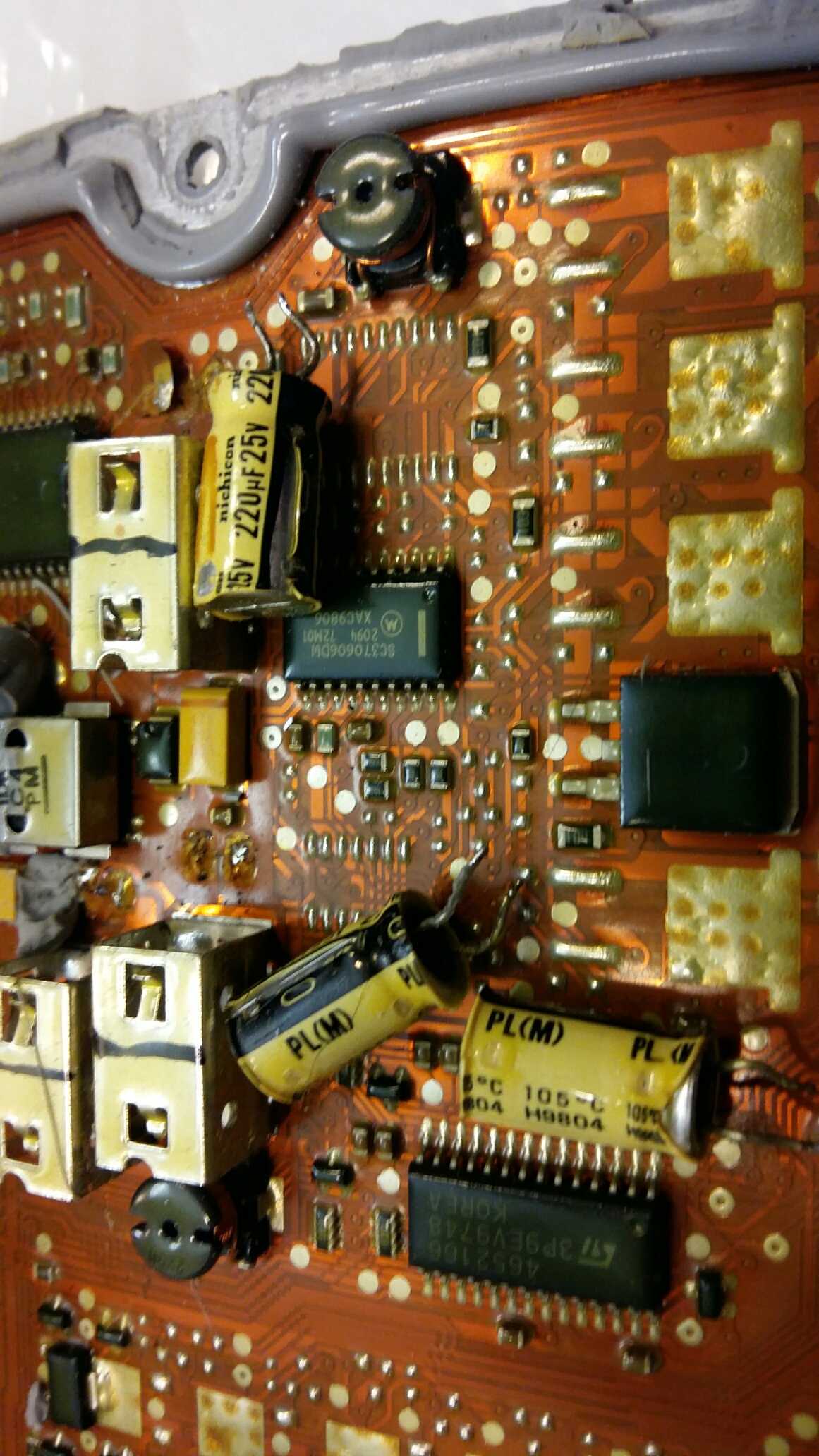

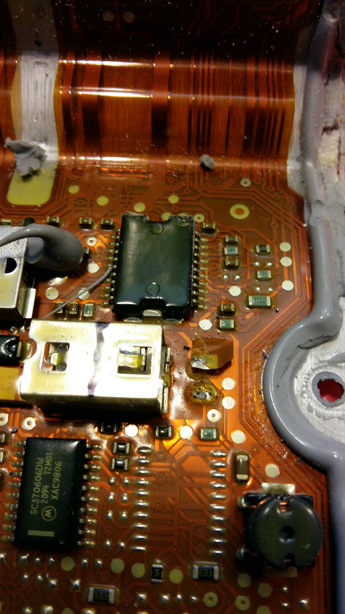

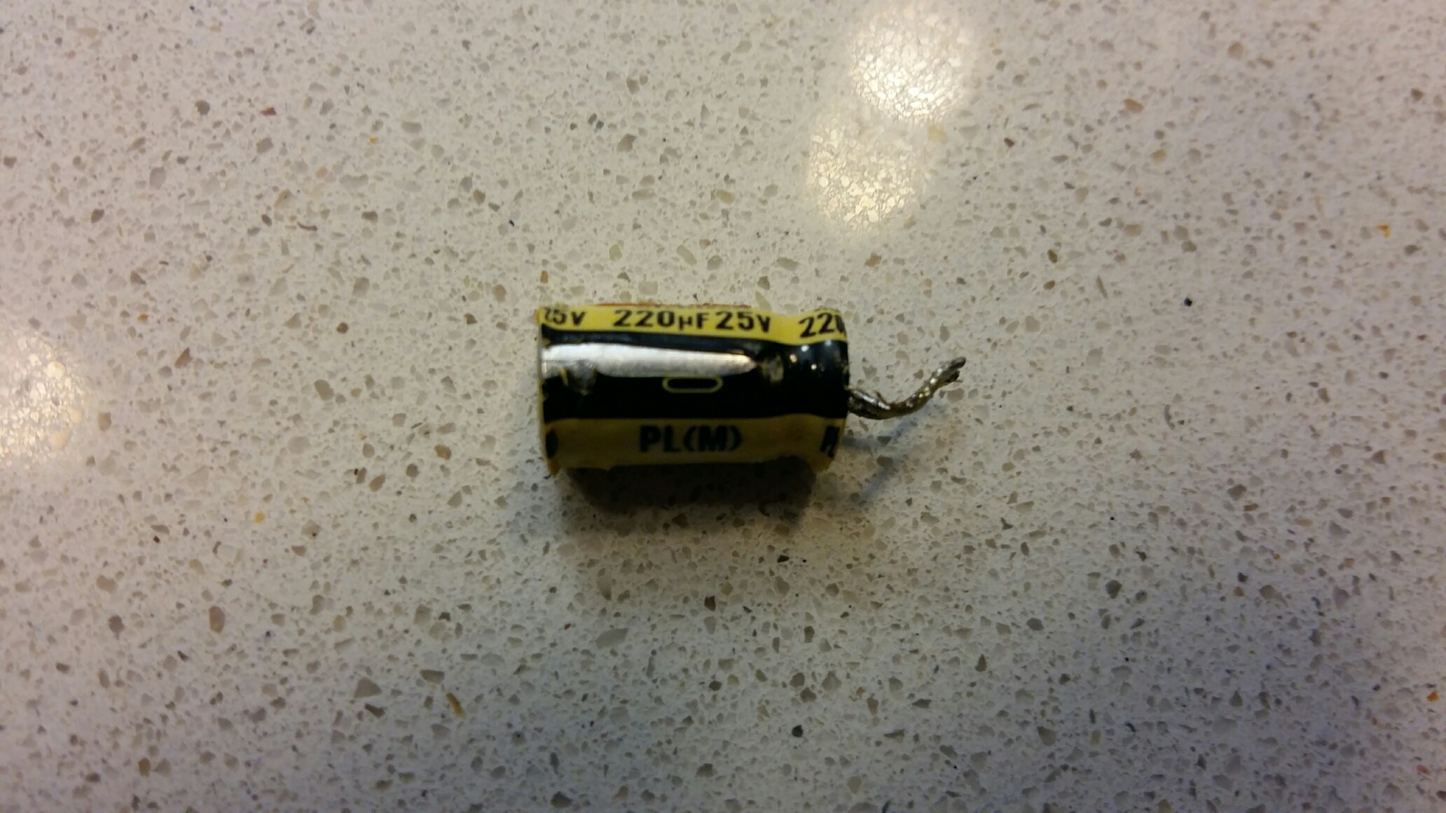

Ok, so the capacitors are removed. this board has only one side I guess, it is glued on a metal case, it is not a solid board, it is a paper thin board, that cannot really be peeled off from what I can see. The capacitors were in these metal brackets(see picture) . I just took a soldering tip, and pulled em off with a long nose. They seem to be poked through.

We really don;t know if the board is double-sided or not or if there was a connection to the other side.
What we now know is that the radial capacitors were tack soldered to the board. This isn't the usual way that capacitors are mounted. They did it to conserve space.
you should be able to tell if there is evidence of a VIA https://en.wikipedia.org/wiki/Via_(electronics) under the lifted trace. It's not likely because there is no hole.
Tacking the capacitor to the board is common, so it doesn't flop. The adhesive needs to be removable and not contain acids.
So, in this case I'd suggest, check for vias. https://en.wikipedia.org/wiki/Via_(electronics)
Epoxy the traces down. Let dry.
Use something to insulate the leads or use what was used before. Clear Teflon (PTFE) tubing would be a production option. Heat shrink or a piece of wire insulation even colored properly. Don;t stress the leads when bending. Tack into place with something. e.g. rubber cement. Solder. Clean off the flux and re-apply some sort of conformal coating. There is enough space on the pad to solder too.
Removal was probably a problem because you did not realize that the coating had to come off first. Usually mechanically. The coating doesn't conduct heat well either. That's your rookie mistake. So, you overheated the pad.
The pics made a big difference. Thank you.
You can see the board is double sided because it is translucent. The tracks on the back are clearly visible, as are the vias. Just can't tell if there are any in the capacitor pads.
