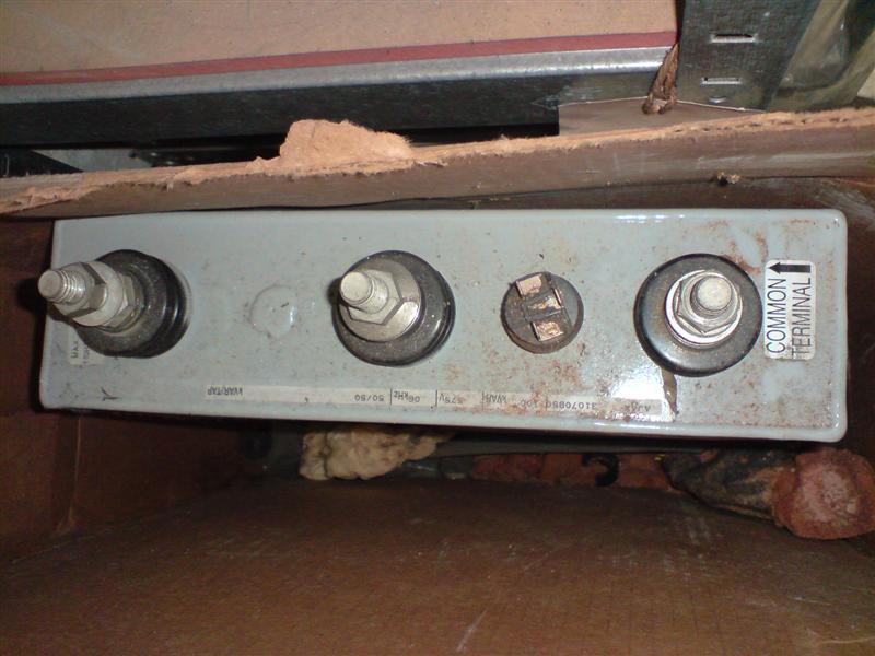

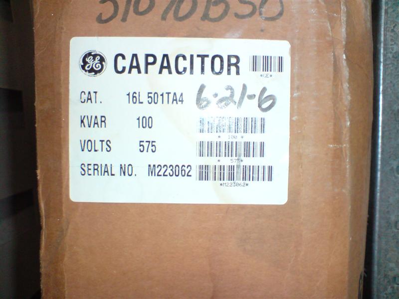

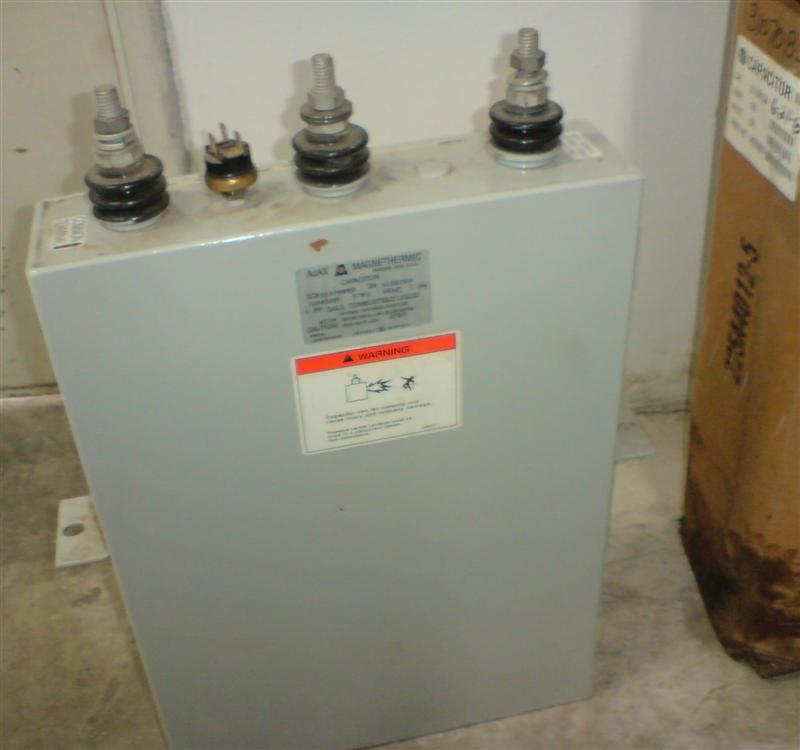

How do you check a capacitor rating kVAR 100, 575V and 60hz with charge
and discharge method?

What do you mean by rating?
It's rated to 100kVAR at 575V 60Hz.
If you want the capacitance then it's more sensible to calculate it.
If it will take 100kVAR at 575V (I assume this is the RMS AC rating, not peak).
Xc = V²/kVAR
C = 1/(2πFXc)
