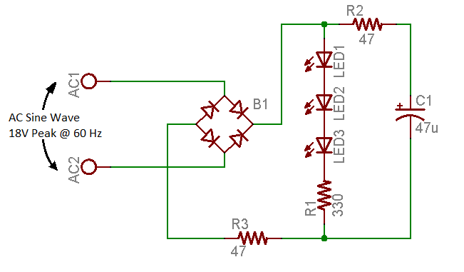

Hey everyone. This is probably a pretty basic question for some but I'm not sure of the answer. Basically, I'd like to know how to determine a capacitor's power dissipation capability. I did a quick Google search but didn't find any clear answers. One site said that ESR was a measure of power dissipation capabiltiy and another said that ripple current was.
I'm thinking about using this 25V 47µF cap in an LED circuit. I simulated the circuit and the cap's power dissipation is going to vary. The graph of power dissipation essentially looks like a full wave rectified sine wave at 60 Hz and according to simulator, the cap will have a peak power dissipation of 360 mW. How do I know which caps would be suitable? Thanks in advance for the assistance.

I didn't mean to suggest that I'd be determining the maximum power dissipation capabilty of the cap. What I meant to say was how can I tell if a specific cap's power dissipation capabilty is greater than what it will experience in the circuit. I read the link you provided and while it was informative, unless I missed something, it didn't really answer my question. It was an explaination about how to determine how much power a cap will dissipate for a given set of conditions but not how much power that cap can dissipate. I'm sure I can just build the circuit and see if the cap gets hot or not but I'm sure there is a better way to go about component selection than that.
I posted a schematic of the circuit the cap will go in. Can anyone say if the cap I linked to in my original post is suitable? If not, can someone suggest an alternate one? Thanks everyone for the input.

In your original post you said you had run a simulation. Instead of using the simulation to determine the "power dissipation" in the cap, determine the RMS value of the ripple current in the cap and see if it's below 83 mA.
Ahhhhh, that makes sense now. So as long as the current the cap recieves while charging or provides while discharging is below the ripple current, I'm OK. Is that right? The simulation showed a maximum current of ~ 30 mA while charging and ~ 13 mA while discharging. So I take it the cap I linked to in my original post is good. Thanks!
Hi vne,
Your schematice says 18 volts peak, but I bet it means 18 volts peak to peak or the voltage will be too high for your cap.
But in either case the ripple current is ok.
You need to use the RMS value of the current through the cap; given your max values, the RMS value will undoubtedly be less than 81 mA. It would be a good idea to check the ripple current through the actual cap. Measure the voltage across R2 with an RMS reading voltmeter, and use ohm's law to calculate the current.
Ronv,
It's not 18V peak to peak, it's 36V peak to peak. However, the voltage the cap sees will be rectified. After the voltage drop across the diodes in the bridge rectifier and 47Ω resistor, the max voltage the cap would ever see shouldn't exceed 12V - 13V. Is that not correct?
I didn't bother calculating the RMS value when I saw the peak was well below the ripple current. Like you said, it's impossible for an RMS value to be greater than the peak value. But I'll make sure to measure the current on the physical circuit once built. Thanks!
